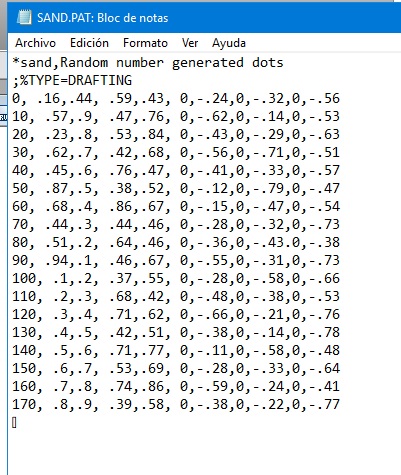

Hello people, i have done some custom fill patterns with no problem by importing an edited acad one but, trying to import this one (attached file) i always got "no drafting pattern found". Thinking that the problem could be that revit doesnt accept 0 segments (for dots) i changed it to 0.0001 but it didnt work either.
Any clues?
thank you

They normally have a couple of lines that refer to size and version.
Like this.
;%UNITS=INCH;
%VERSION=3.0
*Earth45, Earth or ground (subterranean)
;%TYPE=DRAFTING
-45, 0,0, .25,.25, .25,-.25
-45, 0.0663,0.0663, .25,.25, .25,-.25
-45, 0.1326,0.1326, .25,.25, .25,-.25
45,  0.1768,0.1326, .25,.25, .25,-.25
45, 0.2431, 0.0663, .25,.25, .25,-.25
45, 0.3094,0, .25,.25, .25,-.25

please post the pattern itself rather than that screenshot Smile
