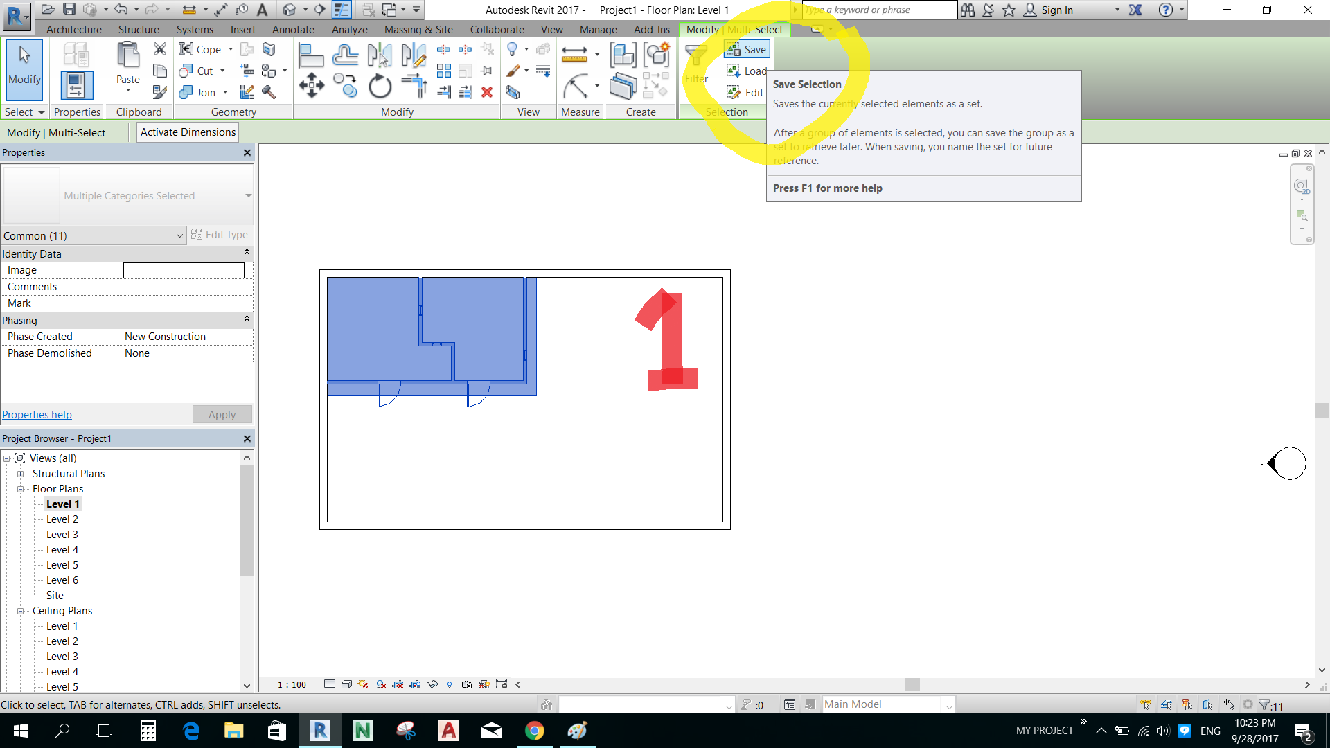

1: Step 1, i selected the unit of a building, say a flat, that is to be copied to multiple level, then i saved that selectetion with a name as shown in pic.
then i use Isolate element for this selected flat. so that i dont have any other elements in the screen, so selection is easy.

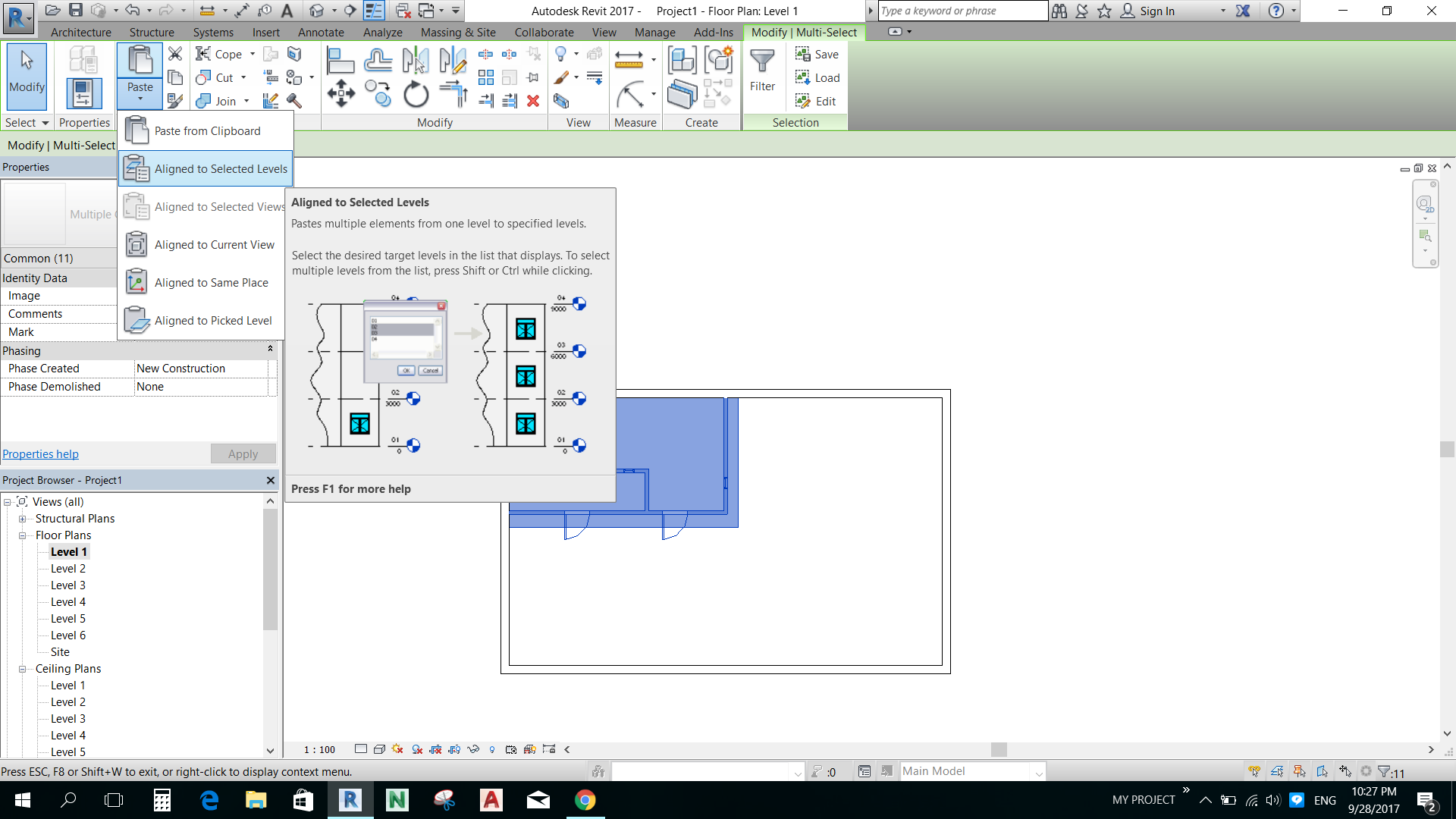

2: Step 2, i loaded the saved selection of name (typical flat), then i copied and pasted to multiple levels. then i used Temporary hide option for the saved flat. so that i will see only the new copied flats on multiple levels in the screen.

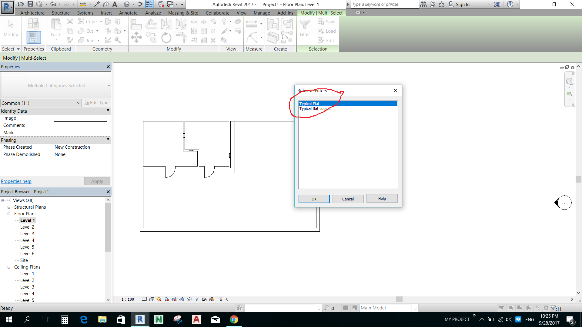

3: Step3, I slected all the copied flats and gave a new name as copied flats, to make a new set of selection to save. then i reset temporary hide option.
Now if my typical floor design changes, i will load the copied flats, and i will delete all. then i load and isolate the first saved flat, i will change design, then i will copy it to the levels.
