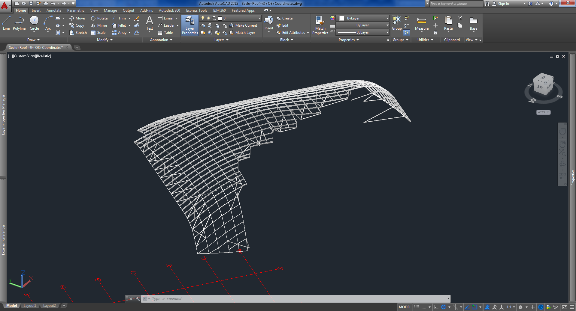

Felt the need to post this solution as I had alot of pain getting to the bottom of this and this in the end was the only way I found that worked and felt it worth sharing.For those not familiar with 3D dwg’s in revit. They don’t respect the cut planes for plans / elevations / sections. A result of this is they become practically un-usable for many views  that we would need. There is a few ways around this if you look online (e.g. linking a DWG to a mass in place is one way). But this tends to work with smaller less complicated DWGs. For a recent job we had a particularly complex glazed roof structure. The consultant only worked in 3D in autocad and the model was quite complex, including every bolt and screw. This was a significant amount of trouble as we had to produce a number of sections/elevations that couldn’t work using the DWG we were provided.
The consultant produced a glazed roof structure in autoCAD using 3D blocks for all the various components. In autoCAD it appears as the attached image Crying"roof-correct-appearance.png") Which looks correct.

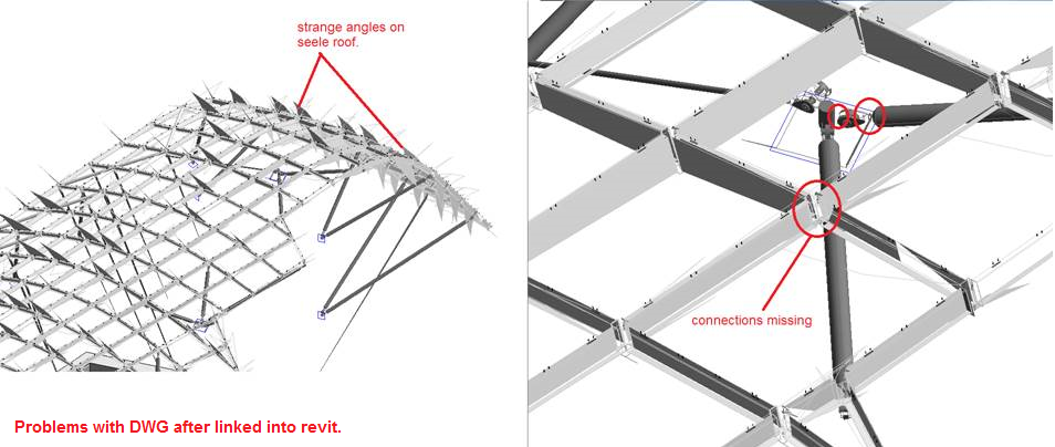

However when it is imported into revit (and other 3D design programs) parts are missing or become warped. (see image "Roof-after-import.png", this is after linking the model into revit)

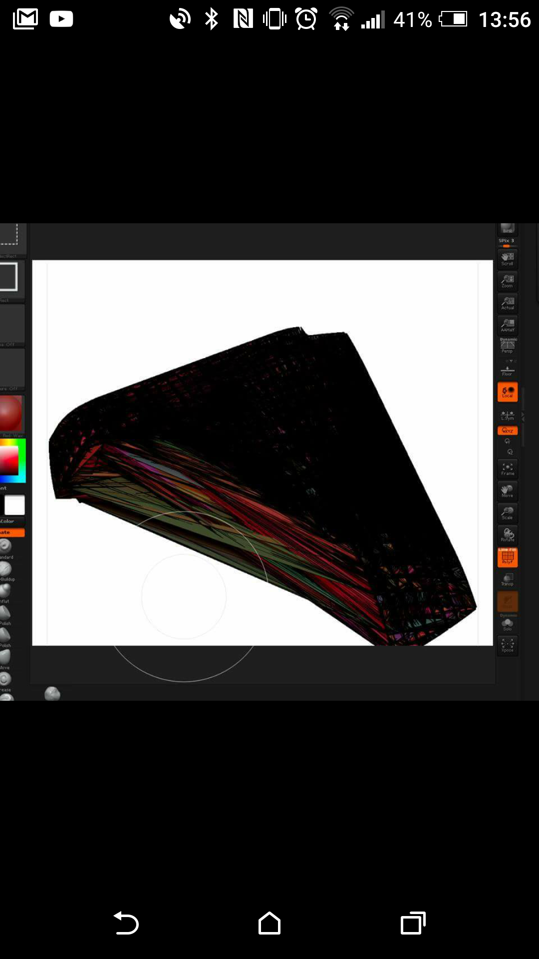

I believe the unusual angles are caused because the blocks in autocad are using nodes points to create the shape. This looks correct in autoCAD but the nodes imports into revit and faces become joined to it. This is just my suspicion as each block was quite complex and was distorted even more when brought into other 3D packages (image attached called "zbrush.png" is from an import of the same file into zBrush where the distortion is even more extreme).
