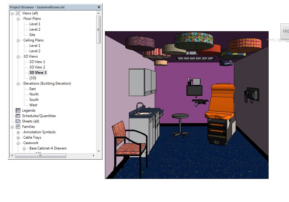

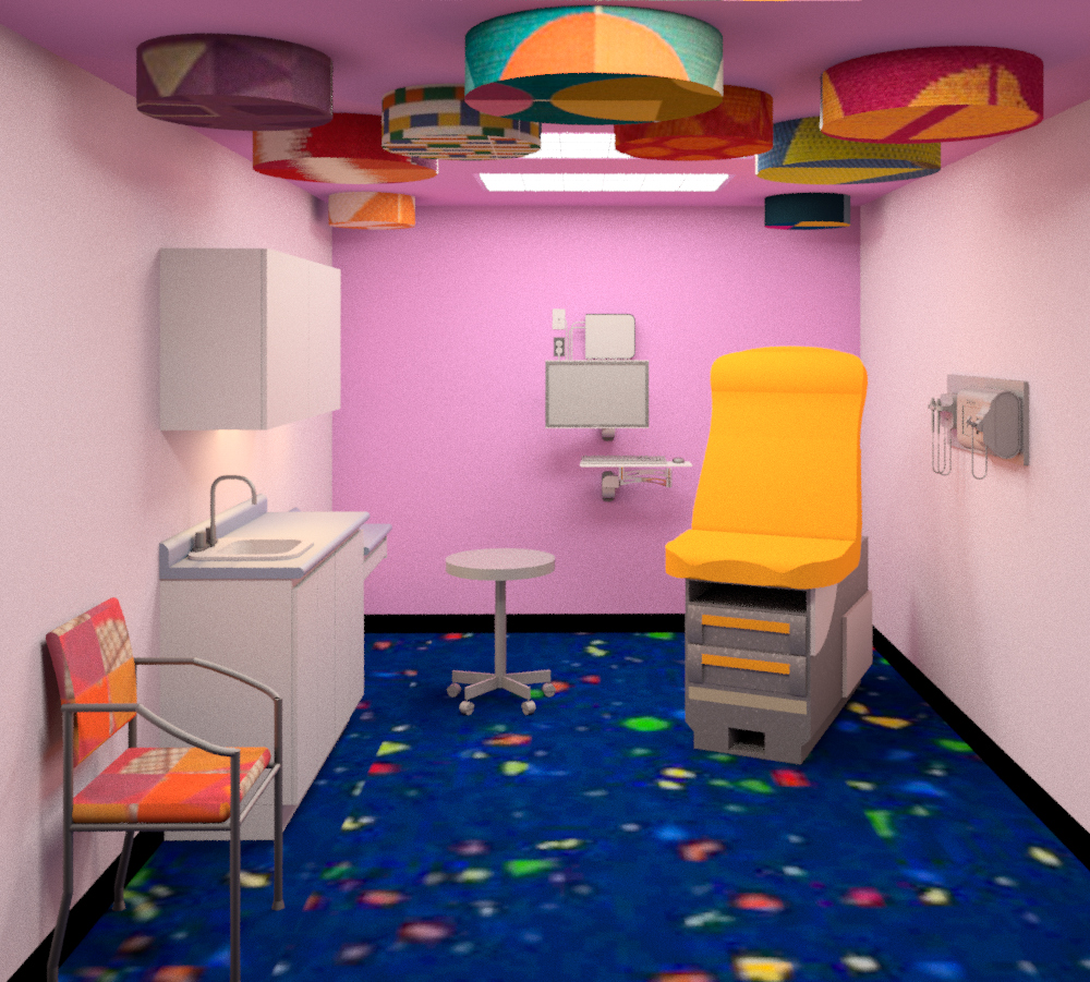

Hi everyone, So my issue is my patterns I have all as jpg show up on rendering in revit smaller and like I want, then when I render in the cloud the patterns are to large. I want my patterns to stay small. Pictures attached.

Make sure you install the latest updates for your version of Revit as forum history suggests they may have fixed this. See link below:https://www.revitcity.com/forums.php?action=viewthread&thread_id=31273Work case scenario if that doesn't work, you are going to need to ignore how your textures appear within the rendering engine of Revit and change the scale of your textures to suit how they are going to appear in the rendering engine of Render To The Cloud.
