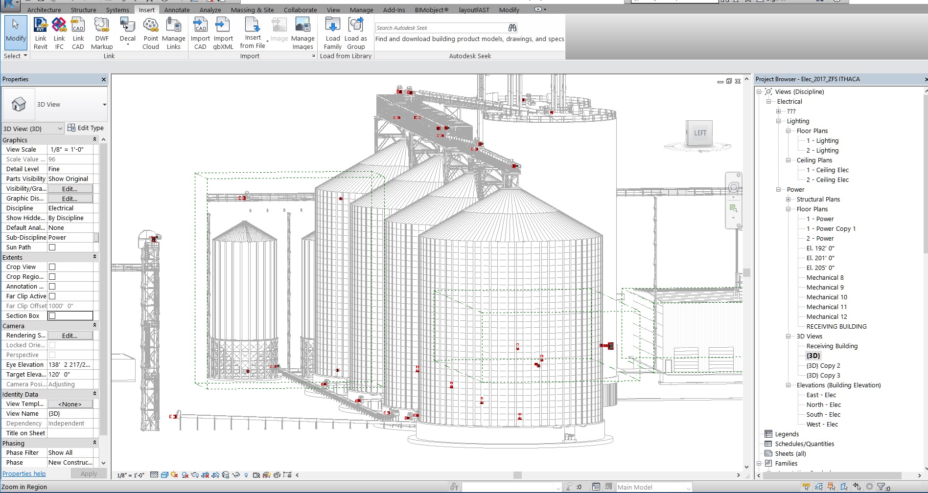

I am starting a new project on Revit, I'm using the Default Electrical Template, but when I link the Revit file of a building, it becomes into a transparent building and I can see everything beyond the structure.
I used the Revit 2016 and I have the same problem.
If I use a different template (Mech, Arch or Struc) I don't have that Issue, but I need to use the electrical one.
There's a picture attached to make it more clear,
Fri, Jul 7, 2017 at 11:19:03 AM | Revit files Linked are transparent when using Electrical Template! REVIT 2017
The view you posted is not transparent.
Views are controlled by templates and by discipline and then by VG settings or filters.  I do not see a template applied.  Setting your discipline to coordination will change how this view is shown but that may not be what you want.
