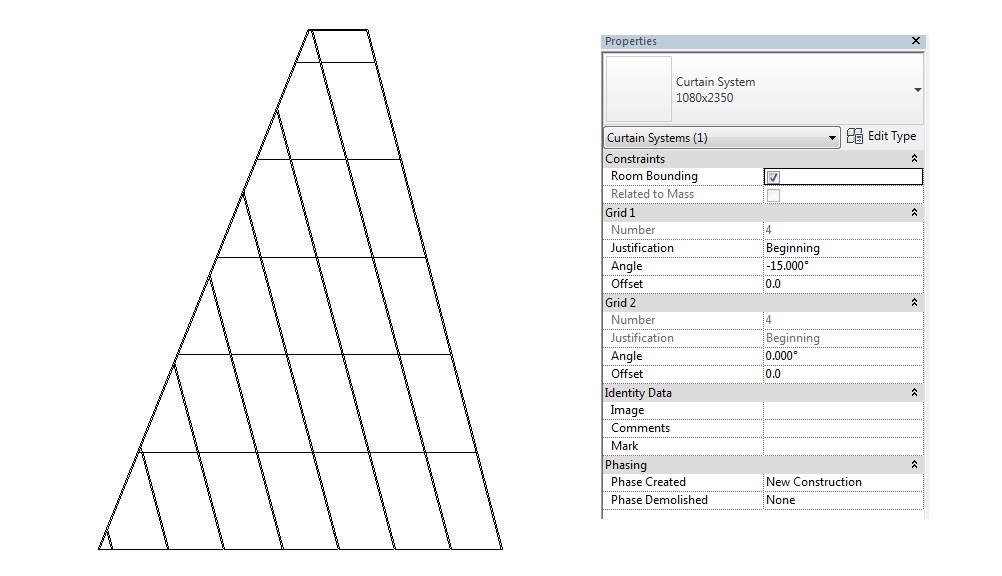

Hi All,
I've seen answers to similar questions on here, but none really fit with what we are trying to do.
We have a curtain wall, with the vertical grids sloped at -15degrees. The horizontal are left at 0deg. Screen shot attached.
This forms a skewed curtain grid. What the project architect wants do do is divide each panel diagonally into 2 separate triangles (each panel can contain 2 triangles which have separate material parameters). Screen shot attached showing detail lines for intent.
I have tried building a new panel family, however this only changes about 6 or so panels in the center. Will i need to create additional panels for all of the edges? Is there a better way of doing it?
We are using Revit 2015.
Any help would be much appreciated.
Thank you in advance.
154965_Proposed_curtain_wall_Detail_lines_shown_for_intent.jpg154965_Currently_modelled_curtain_wall.jpg

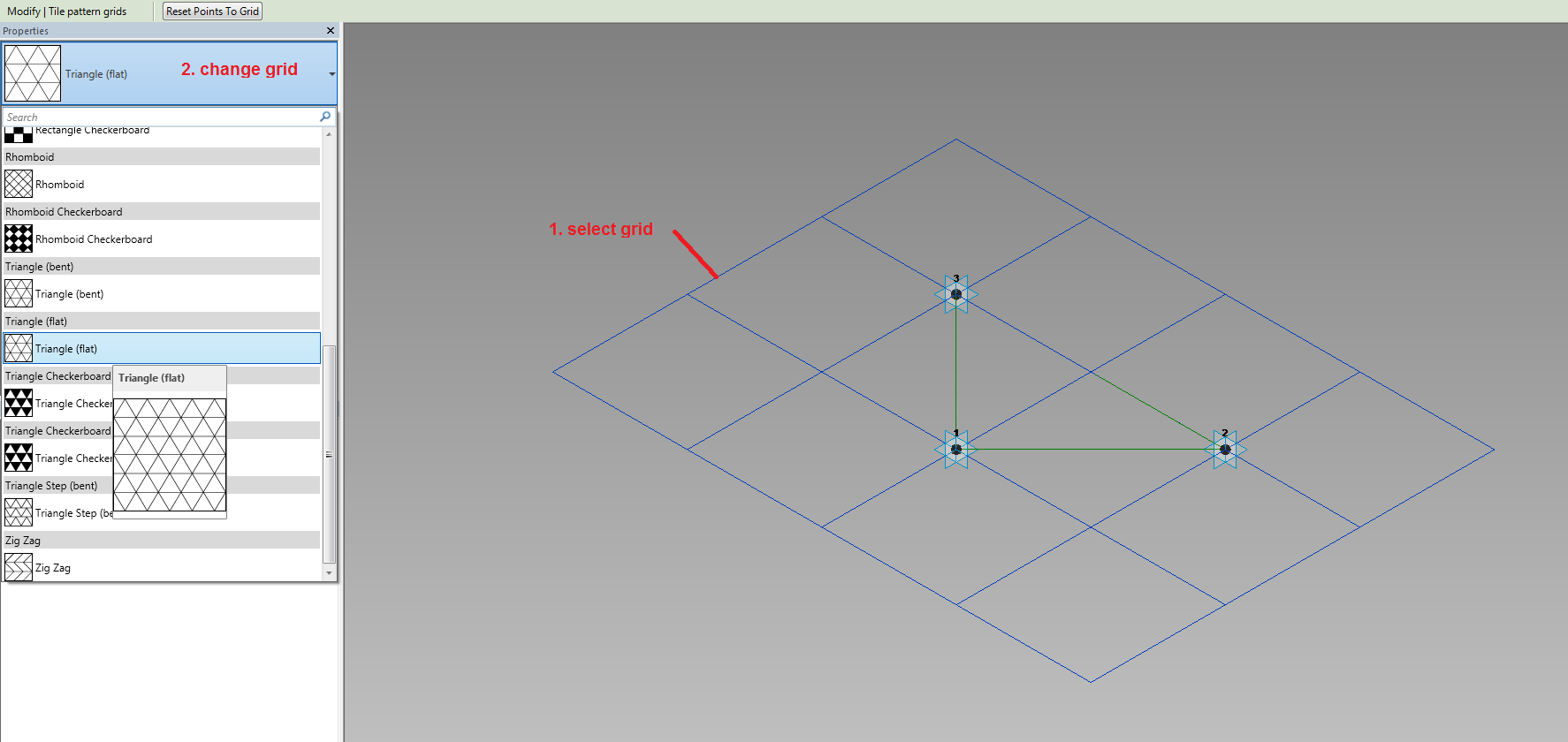

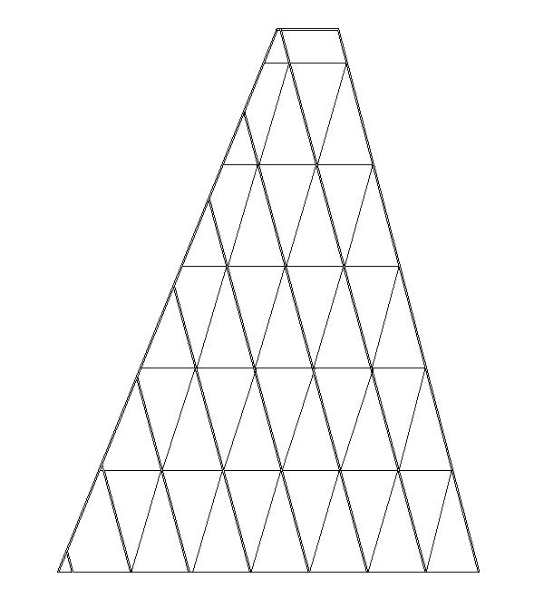

Mon, Jul 10, 2017 at 7:25:11 AM | How to create an angled Curtain Panel
marmiketin1
Joined: Wed, Aug 19, 2015
0 Posts
4.5 Stars: 10 Votes
You can make this curtain panel family using the "curtain panel pattern based" family template and then changing the grid to be triangles.
