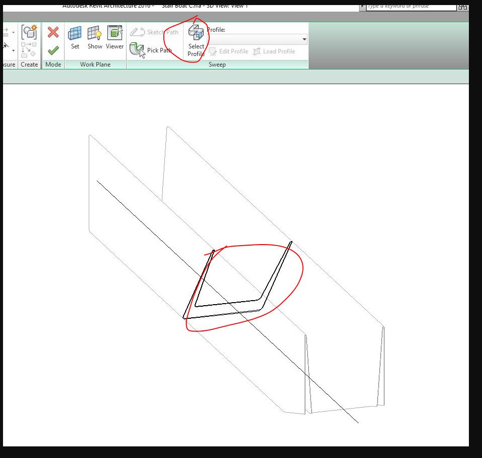

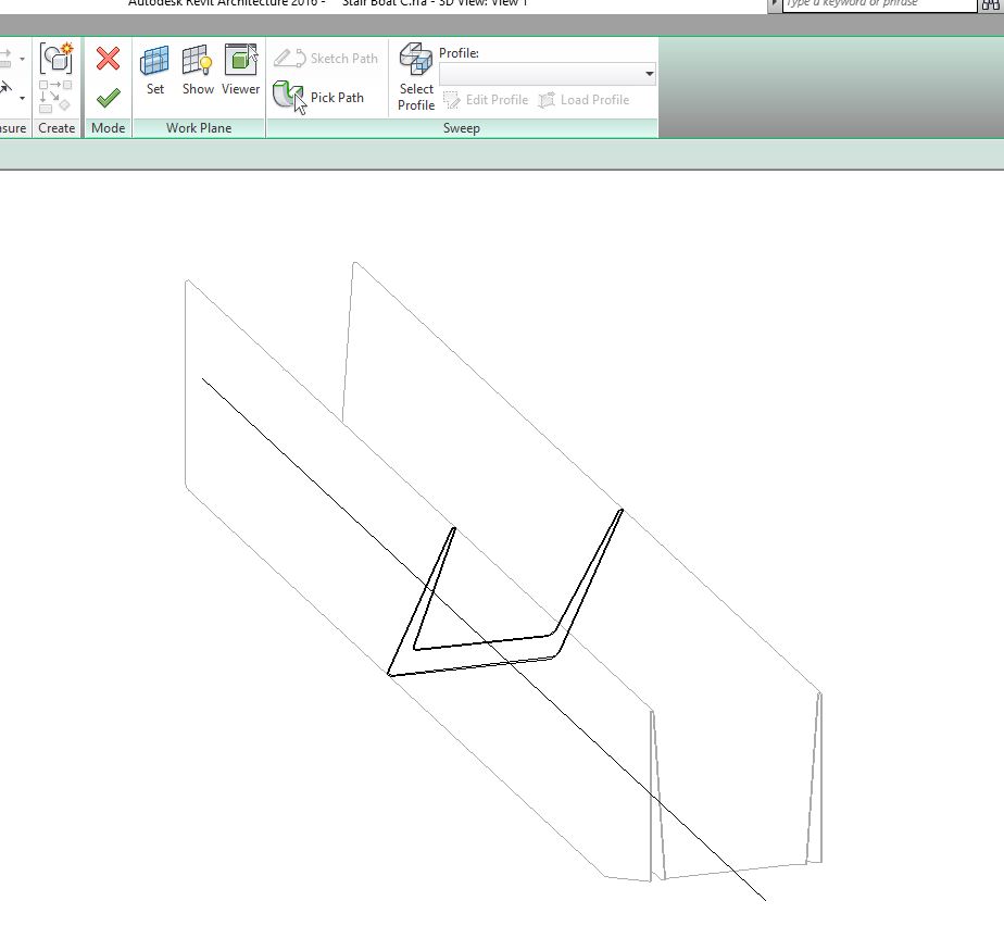

Hello everyone,
i recieved a model from another firm and now i need to change a profile in a nested family. however, when in the edit family-edit sweep I don't have the "edit profile" option available. I don't know if the profile was created in revit.
Thu, Jun 29, 2017 at 12:30:10 PM | not able to edit profile in sweep
Click on that down arrow under profile...it may be a seperate loaded profile family.
Thu, Jun 29, 2017 at 12:45:05 PM | not able to edit profile in sweep
noabaram1
Joined: Wed, Jun 28, 2017
0 Posts
It is a separate family, and I can't find the file in the directory.. any ideas before i remodel the whole thing?
Thu, Jun 29, 2017 at 2:19:12 PM | not able to edit profile in sweep
pijpiwo
pijpiwo Avatar
Joined: Fri, Sep 3, 2010
0 Posts
5 Stars: 25 Votes
Select the profile itself or click on select profile, the drop-down window will populate with available profiles. Edit profile option will become available when you select <by sketch> from the drop-down.
Thu, Jun 29, 2017 at 2:49:46 PM | not able to edit profile in sweep
noabaram1
0 Posts
of course it was so easy that i didnt think of it to begin with: select the profile in the project browser and right-click it to edit.
thank you all
