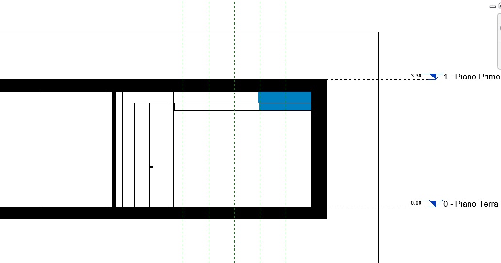

Hi everyone!
Here is my problem: I've hidden all reference planes (by category) in the false ceiling view but now I'm not able to turn them on again. Toggling the bulb "Show all hidden elements" there's no reference plane!
Of course, in my first floor view the planes are perfectly shown.
What to do?
Many thanks to those who will help me.

Make sure ref planes are cutting through the view cut plane in RCP.

As pijpiwo said you need to make sure the reference planes are actually being cut by the reflected ceiling plan. Cut a section in the first floor plan and check where the top extents of the reference planes are.
The same thing can happen in elevations with levels. If the level does not extend into the view of the elevation you wont be able to see it.

Actually they are cutted by the ceiling plan (@ 2.20 m).
I didn't change anything but the visibility of the reference plans in the ceiling plan.
So, before doing that, I could perfectly see those reference planes in the ceiling plan.

Actually, I did but... I'm not able to localize RP.
In which tab I find them?
Fri, Jun 30, 2017 at 11:16:07 AM | Hidden Reference Planes disappeared
unnbe
Joined: Wed, Jan 13, 2016
0 Posts
Found! (in the annotation tab). Autodesk should add a search box.....
In fact, they where toggled off. Now, I got my reference planes back!
