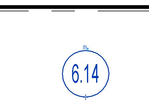

We discovered that one of our keynote tags placed on a plan view did not have the correspnding item populate in the keynote legend.  When I reviewed the issue upon selecting the tag, I saw a small  icon above the tag.  I just didn't know what that indicated.  without making any changes, we are able to place another tag with the same keynote item and have it populate the legend.  But I would like to know why this particular tag's item did not populate the legend.  The answer lies in that small icon's meaning above the tag.

Oops,  I figured as much but before I decided to investigate we deleted the symbol.  I was obssessing so I went to the back up and found the old symbol.  Upon selecting it I saw attached image:

I believe that indicates the tag is 'orphaned'.
On the ribbon, click (Pick New Host).
