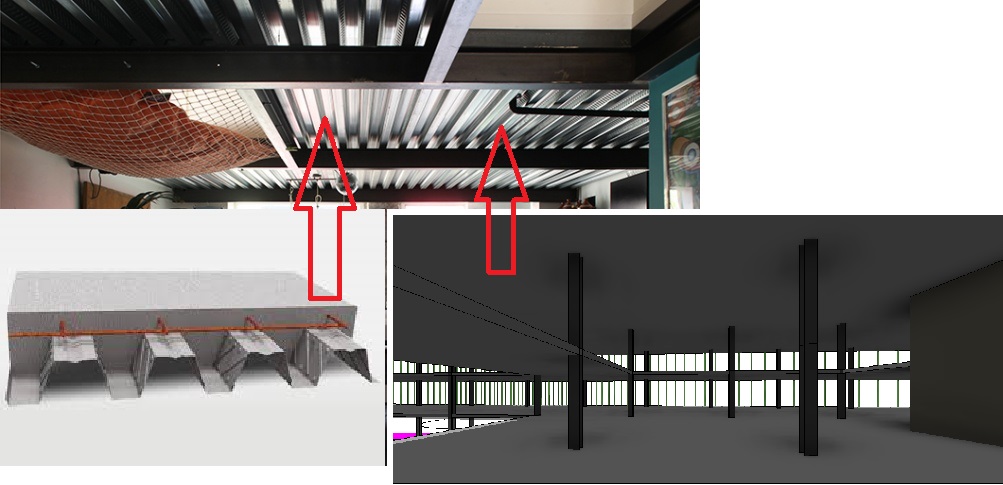

Hello,
I use Revit 2016, it's a student version freely given by Autodesk so, if needed, I think could update to a upper version.
For my final review I am working on a project with a steel structure and with concrete + steel pan floor. I would like to make the steel pan appear  in the 3D view (as in the picture I joined) but I don't understand how to do it, if it is possible. I would need it to make perspective anc section perspective.
I hope you can help me.
aybe I don't use the proper description (English is not my mother tongue), I found an old thread (2009) but it didn't really help.
Thank you

I would follow this procedure to make it look correct in sections, but I am unsure if it works in 3D.
https://forums.autodesk.com/t5/revit-structure-forum/metal-decking/td-p/4378874
If it doesn't, there are a few options:You could make an inplace family and just extrude the shape horizontally everywhere across your footprint and then use a void in plan to cut it to align with the building perimeter.
orYou could make a family of a single metal profile with length parameters and then just load it into your family and space them accordingly.
or
Your could make a family with a child family of the above mentioned description and use parameter arrays to allow a width parameter to also be added.
__________I'm the guy they come to when they didn't follow my recommended workflows.__________

Thank you.
I tried to re-make the floor but no success in 3D views.
I didn't try to make a family / child family, I am not enough skilled to do that.
I tried to modify a beam as suggested in the link you gave me but I am not familiar enough with Revit Families and it was a failure :/
I'll give up for now (no time to cath up my noob level on Families, I'll retry when I am graduated). I'll make them in Rhino and import them in Revit or vice versa.
Thank you for trying Smile

I would do that with a model in place.
1 - create the basic extrusion in section.
2 - Extrude it to the maximum lenghts
3 - Array that to the full width of the floor - you will get a rectangle in plan
4 - Create voids to form subtract from the edges and inner voids as required.
