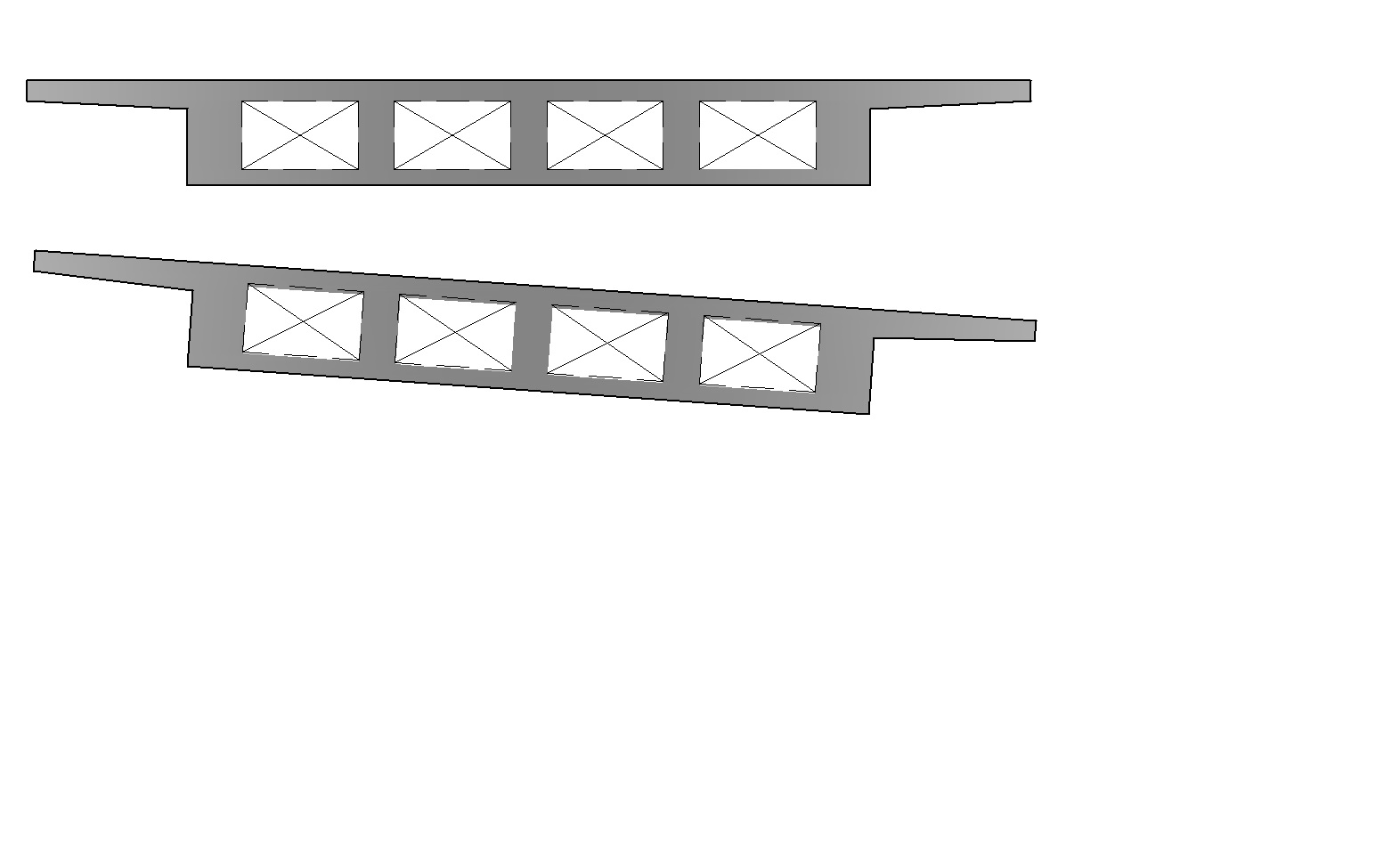

Good evening everyone!
So, i am trying to create  a bridge slab in revit. It is a slab with voids. To create voids i use the "model in place" component. Everything is fine working in a plane.
To create the exact bridge slab shape, I have to add reshaping points so i can get the acclivity and he declivity. Unfortunatelly, void floor form is not associated to the  top of the slab in any way. I assumed that if i pick the void floor and check "moves wih nearby elements" button, void would follow he reshape of he slab.
Is there any way i can lock the void with the floor, so that they correspond as one element?
It is of MAJOR importance!
Thank you in advance for your help!

The voids are rectangular in section. Also i use void floor to cut the bottom of the slab (right and left in section) so that i can have the section shape of the cantilevel slab (slab with variable thickness). I need this specific section, first, to follow the road axis and second, that i can edit the level (offset up or down) at the right and the left limit.

Sorry but you were not very clear.   Right/left doesn't mean anythin without context - across ?.  A sketch would help a lot.  This may not want to be a slab but rather an in-place solution of extrusions and voids.

Here is two typical sections. Hope to be helpful. Thanks again a lot!
Thu, May 25, 2017 at 7:18:47 AM | Slab with voids and reshaping points
You can't do this with a slab or even typical in-place elements.

What you showed is a twisted deck.  Sloping in probably two directions as it twists.   It is not a simple slope.  For a simple slope with those voids, you would do an in-place extrusion.  Solids and voids all in one sketch.
