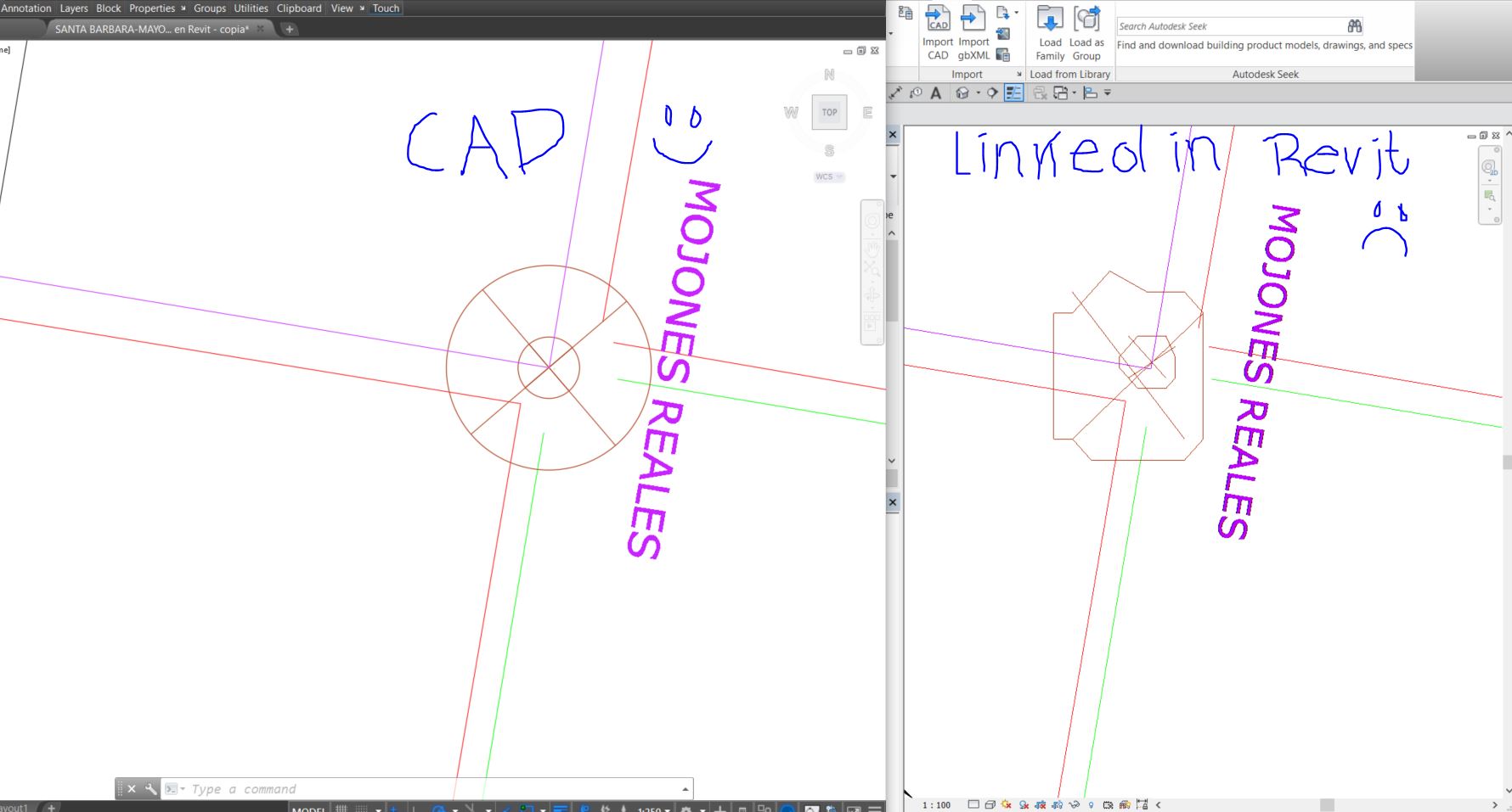

Hi everyone.
I´m trying to link CAD in Revit, every thing goes well, but when i have to make zoom in some elements it´s showing so wrongly; i made purge, Audit the CAD file, redefine the origin to 0,0 but its dont resolve anithing.
Can some body help me please?, i dont know why its looks so bad, and this trouble its hapennig whit more than one file.
File attachments: image with the diference.
Thank´s very much for your help.

Try to explode those elements in cad before inporting them and see if that helps. Is that a circle element in autocad?
Did you move the cad drawing closer to the origin?

Hi Archigrafix.
Thanks for your response, in this case works fine making explode to the CAD elements, it wasn´t necesary to move the origyn point of the CAD, which allows me adquire coordinates from this file to Revit.
So grateful for your help.
