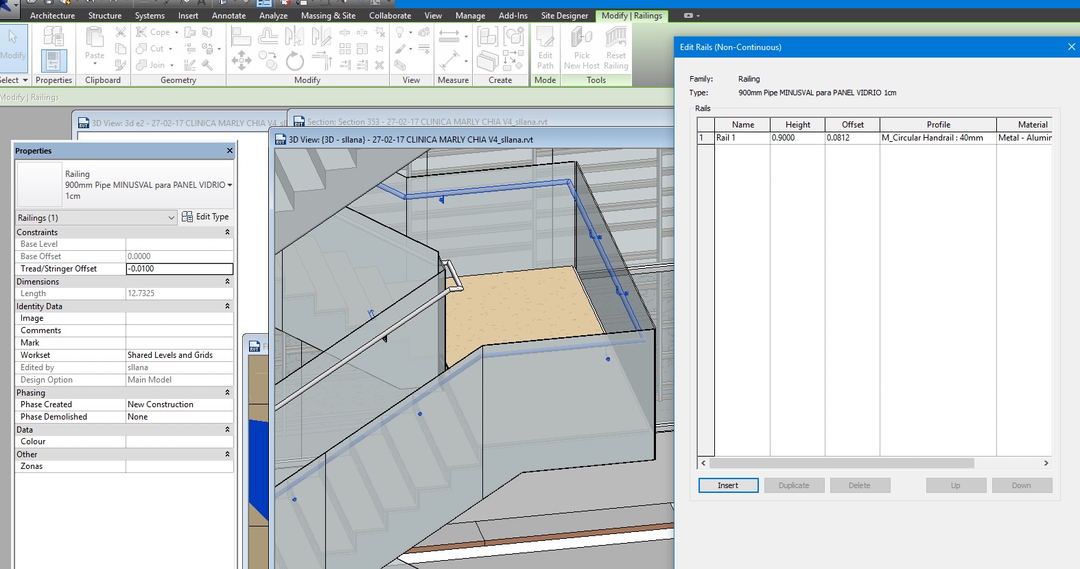

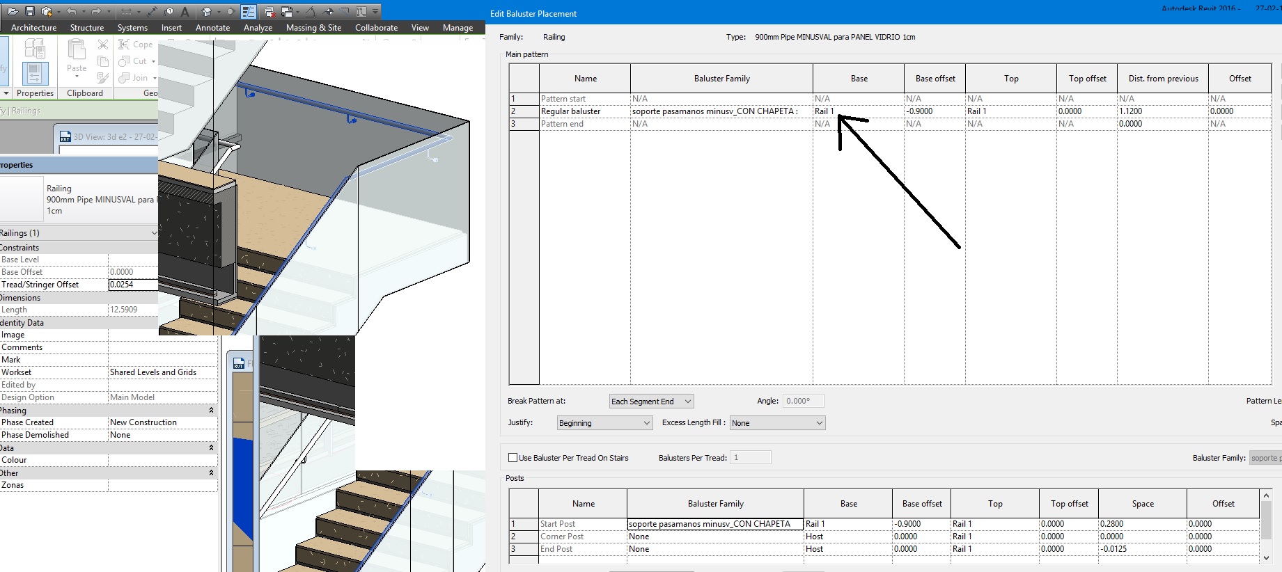

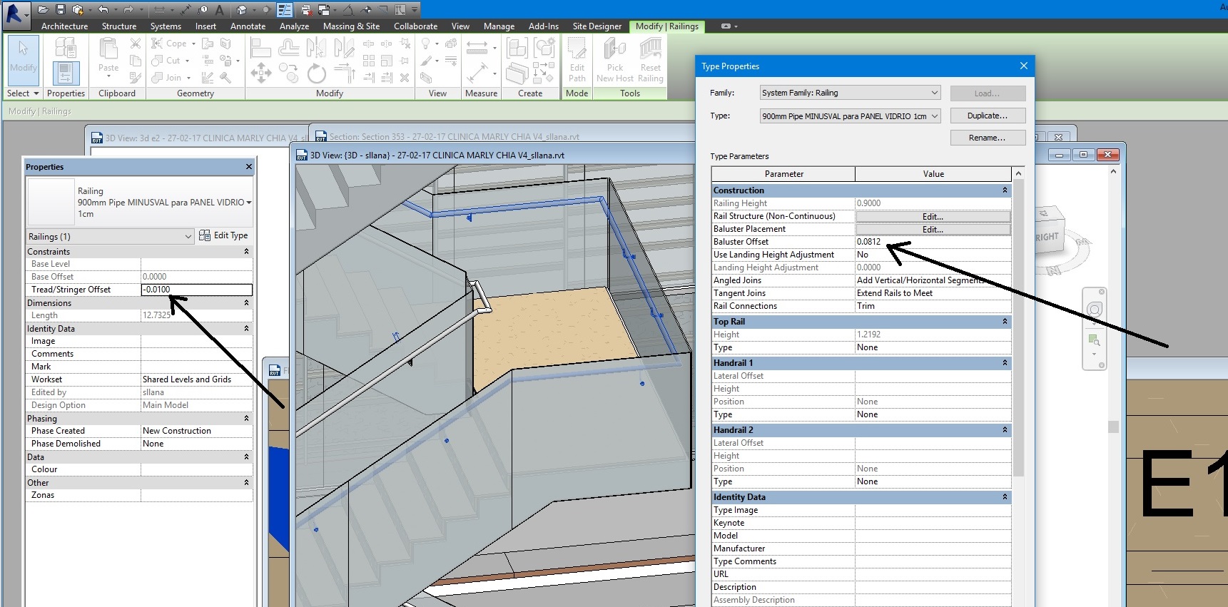

Fri, Apr 28, 2017 at 5:35:54 PM | Handrail - Wall mounted
sllana
Joined: Wed, Mar 2, 2011
106 Posts
5 Stars: 2 Votes
use these, baluster and settings, guess you u have to convert to imperial; and give it a try
No top rail but  rail1 40mm = 1.57" diam.  at 3' height
