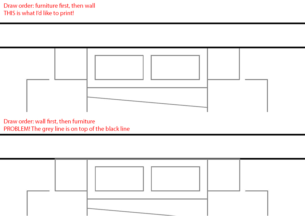

Hello everyone,
Is it possible to chage the draw order in Revit 2017? If I have grey objects close to a wall, the grey lines come in top of the thicker black line of the cutted wall. I found that if I place grey objects first and then walls I don't have this problem, but it's tricky. So my question is if it is possible to bring the grey objects under the wall.
Please see the image attached.
I know that I could use Bluebeam or something similar to set line merge, but I'm looking for a no-expensive solution.
Thanks either way.

actually i tried to recreate the problem u have , but i couldn't , both ways the furniture goes under the wall in my project , i changed the category of the furniture to something else and also it wouldn't happen , but if you need an urgent solution - a non expensive one - you can select all your wall and cut them to clipboard and paste at the same place , " if you can attach a file with the wall and the furniture only it would help "

This may not be a real problem, did you check on how it plots?
Your furniture is probably symbollic line work.  Would it really be against the wall?  < Only if wall mounted headboard.
