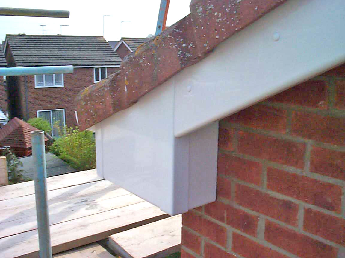

Hi all, new here so bear with me. Im looking to create a fascia box as in pic attached. Its driving me mad!! Any help appreciated.

You can't do this with out of the box elements.   I created a family to do this but I don't have it available to share.  You can create your own if you have done any families.  If I remember correctly, my family was level or floor based, had a fascia height adjustment, a return depth adjustment and a roof angle setting.  The material could also be set to match the fascia.

Thank you. I havnt done any families yet as i am only using Revit for a couple of months but i will get practicing! Thanks again

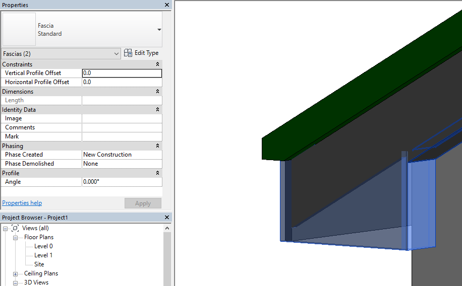

Actually it can be done using out of the box elements that are also catagorised correctly, I quickly threw together the attached project and image,
It is made up entirely of Fascias and soffits attached to either the roof or each other. the nice things about fascias is that they can attach to the edge of anything that has the roof category.
Hope this helps. Winking
