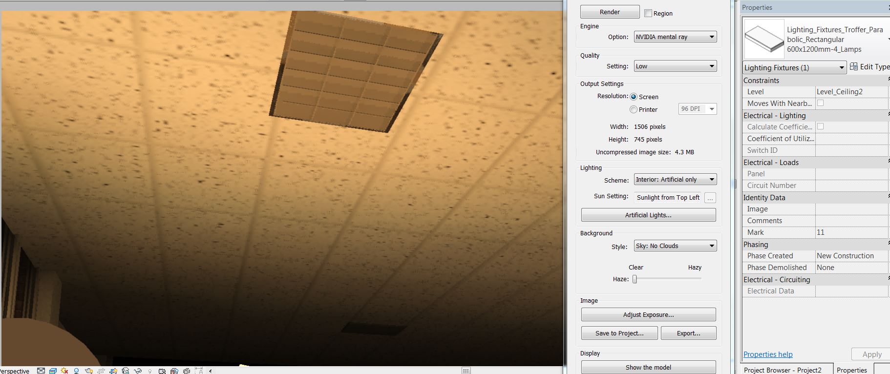

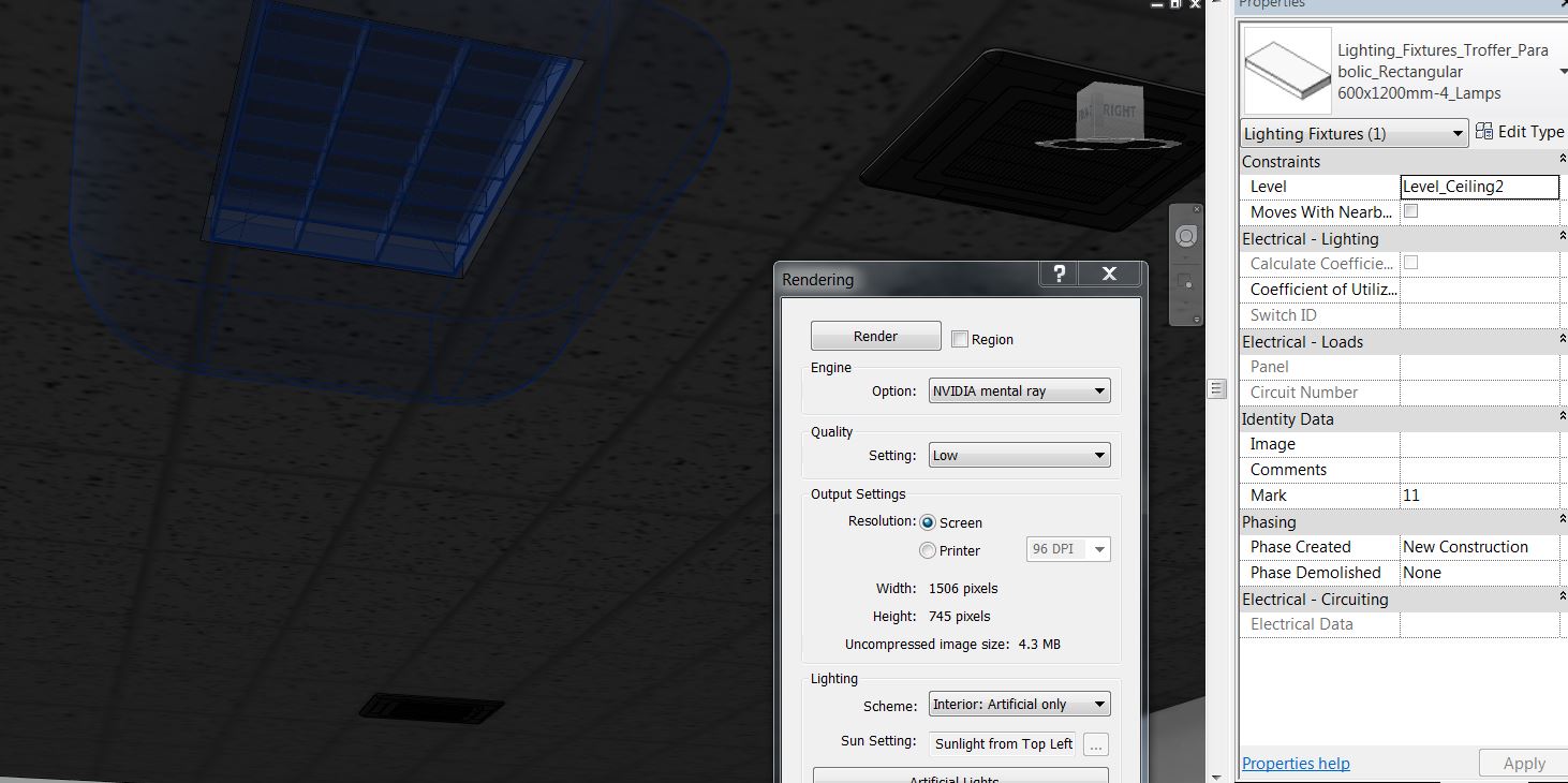

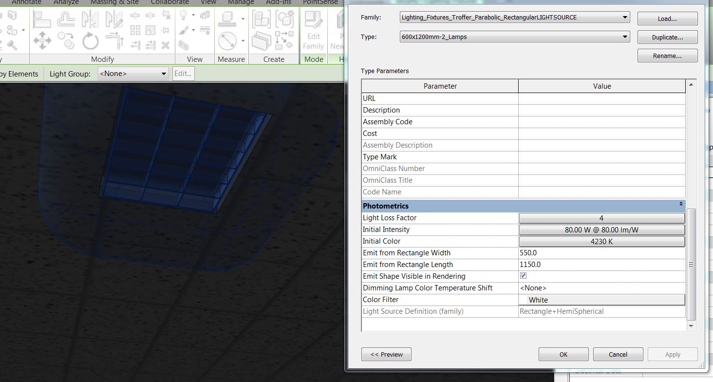

Hi All..
Im having an issue that im sure many people have come up against.
I cannot for the life of me get the light source to show up in a render. The fixture illuminates the scene just fine but the light source isnt showing.
CAn anyone help with this issue ( was gonna say "can anyone shed any light  on this " lol )
I love Revit but its been an uphill climb today  and im still pretty green with this software.
Thanks in advance for any help .
Kind regards.
Rich Jacob
153371_LightSource.JPG153371_LightSource2.JPG153371_LightSource3.JPG153371_LightSource4.JPG

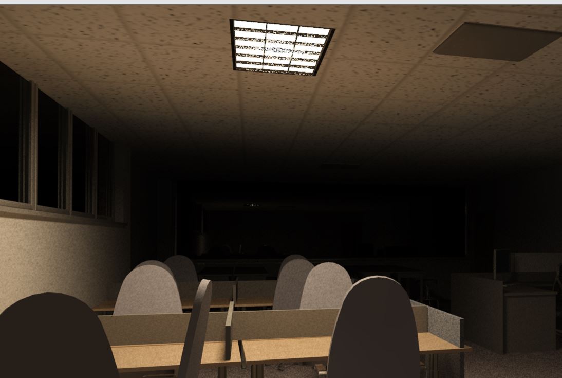

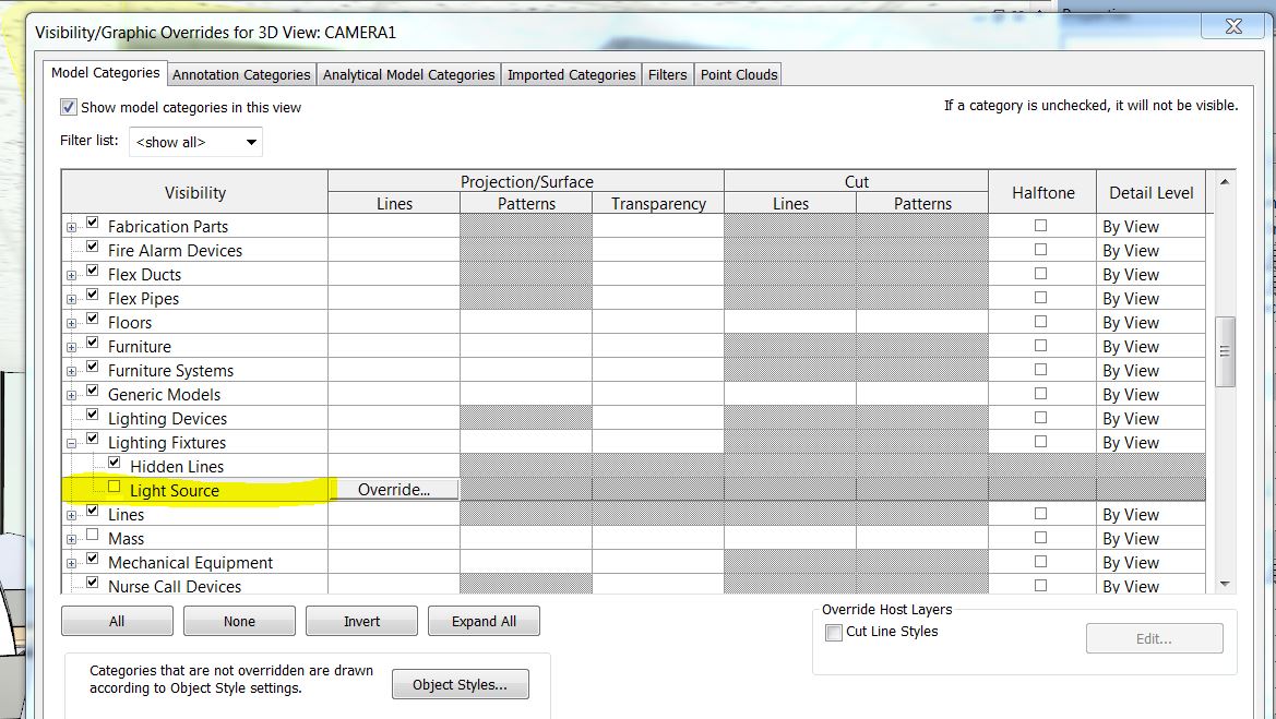

The material of the lens of your fixture has to be set to self illuminate.
Fri, Mar 17, 2017 at 11:09:15 AM | Light Source not rendering.
richjacob
Joined: Thu, Mar 16, 2017
0 Posts
Hi WWhub
Thanks for the reply. Whilst i was scrabbling around for the answer I found it in my visibility settings. Now the light source shows perfectly. I also edited the family for this generic troffer light and lifted the light source up into the fixture a bit which made it look a bit better too.
I will look into your method though as I need to learn more about materials . Thankyou again for your reply.
