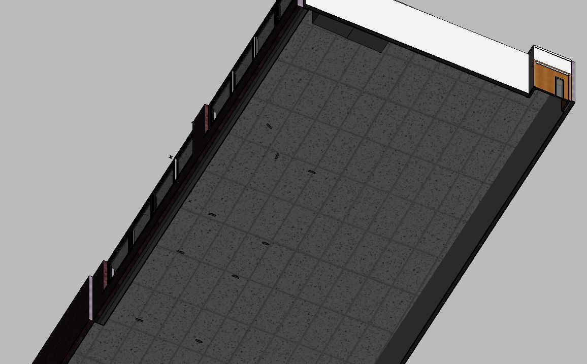

Hi ALl,
I am quite new to revit and I have an issue that i only noticed quite far into a project. When I applied a "Ceiling Tile" material from the revit library the orientation of the tile pattern is not straight/inline with my walls . I am thinking this may be to do with the fact that I didnt correctly set up my project north at the begining of this project. Is there any way to remedy this issue or is there a way to rotate the texture map/image of the ceiling tile material to be in line with my walls ?
I have attached an image of my ceiling.
Thankyou in advance for any help on this issue.

Go to your RCP and turn your view to hidden line, is your surface pattern correct?  If it's not you can rotate the surface pattern which will rotate the image in realistic view and rendering.

Thanks teafoe5 ..
Thats all sorted now. Very much appreciated.
