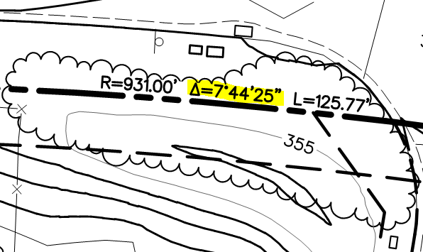

How do you input an arced property line in the table when there is a delta value for the bearing versus N/S, E/W? I tried subtracting from the previous bearing, 90 degrees, but I'm not correct. Does Revit have a way to understand this explicitly? Thanks.

You still need a bearing.  If you don't have the direction, guess and see what it looks like then revise if needed.

I'm finding that I have to perform my own calculations to get the right bearing. I was hoping Revit would have had a way to do this more automatically. Thanks for confirming. I guess Autodesk will have to update the functionality of this feature to allow input for survey information given in this format. Cheers.

How could it be automatic, not all arcs are tangential?  Every good survey I have ever seen has the bearing angle.
Mon, Mar 13, 2017 at 3:28:26 PM | Property Arcs - Input Delta Bearing
BTW - Just looked at your image.  Flip the L/R in your table.
