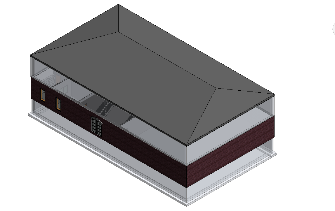

Hi I'm having a problem with my foundation walls and pad being transparent as well as my 2nd floor. Any help please?

Many possible reasons but you have not given us any history.
  • Element over-rides in view
  • material settings

Well it just happened when I started up my project. I stared on a contruction template while on revit 2016. Then my foundation waws transparent in relistic view but in any other view its normal for revit

Yes i am because i can see the first floor just fine its just the foundation and the second floor that are transparent. T he thing i find odd is it onlt happens on realistic not consistant colors

This is what it looks like

You have some sort of filter applied or the wrong materials assigned, it is a user setting somewhere.  It could be a phase filter it could be an over-ride.
We can only help if you give us enough information.  Did you create this project?
Show us the properties for the transparent walls.   Then show us the material settings for those walls.

I had a similar problem on one of my projects. In my case, it was the phase filter that was set to "Show All". I changed it to "Show Complete" or "Previous plus New" and it fixed it. Just a thought.

kkozak2 that worked and WWHub thank you for helping me out as well.

I was having the same problem with walls showing up as transparent when the view filter was set to "show complete". when i looked at the finish material on the wall, i discovered that in the material browser, the material graphics had a transparency set under the graphics tab. once this was set to 0, the problem went away.
