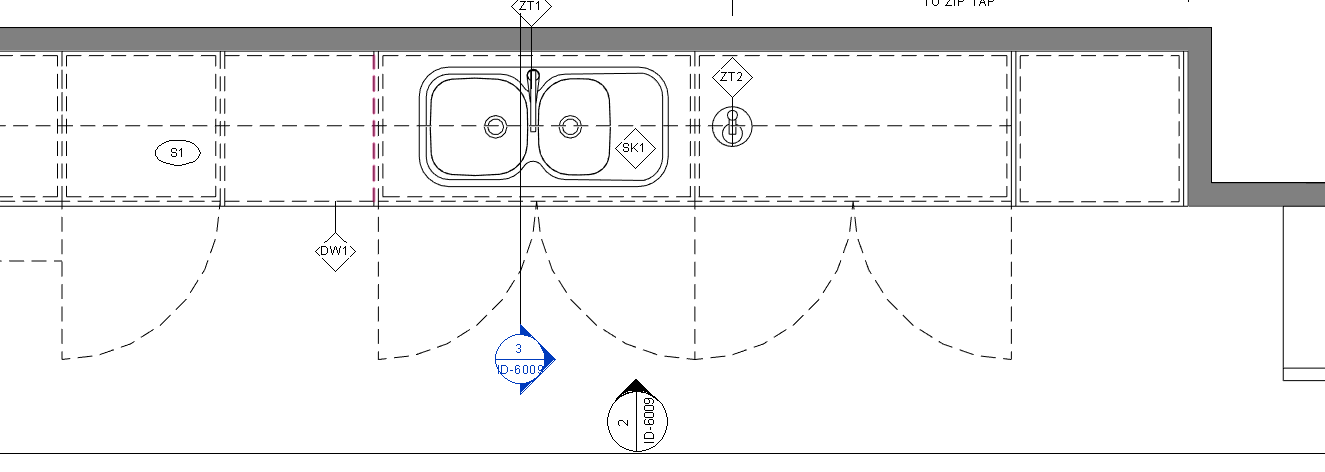

Hi,
I have a plan, it is on a sheet and then I rotated the view on the sheet
Is there a way to rotate the elevation tag as it is reading side ways? I have attached an image for reference.
It needs to be like the section tag.
This is probebly a simple fix but I have no idea what to do with it.
Kind Regards,
Britt
Mon, Feb 27, 2017 at 9:44:37 AM | Revit Elevation Marker rotating
I think you probably used the wrong rotation.  Don't rotate the view on the sheet if you want the text to be 'normal' to the sheet layout.   Instead, open the view, turn on the view boundry, select that and rotate the view.  All model elements will rotate and all text will remain 'normal' to the screen.
