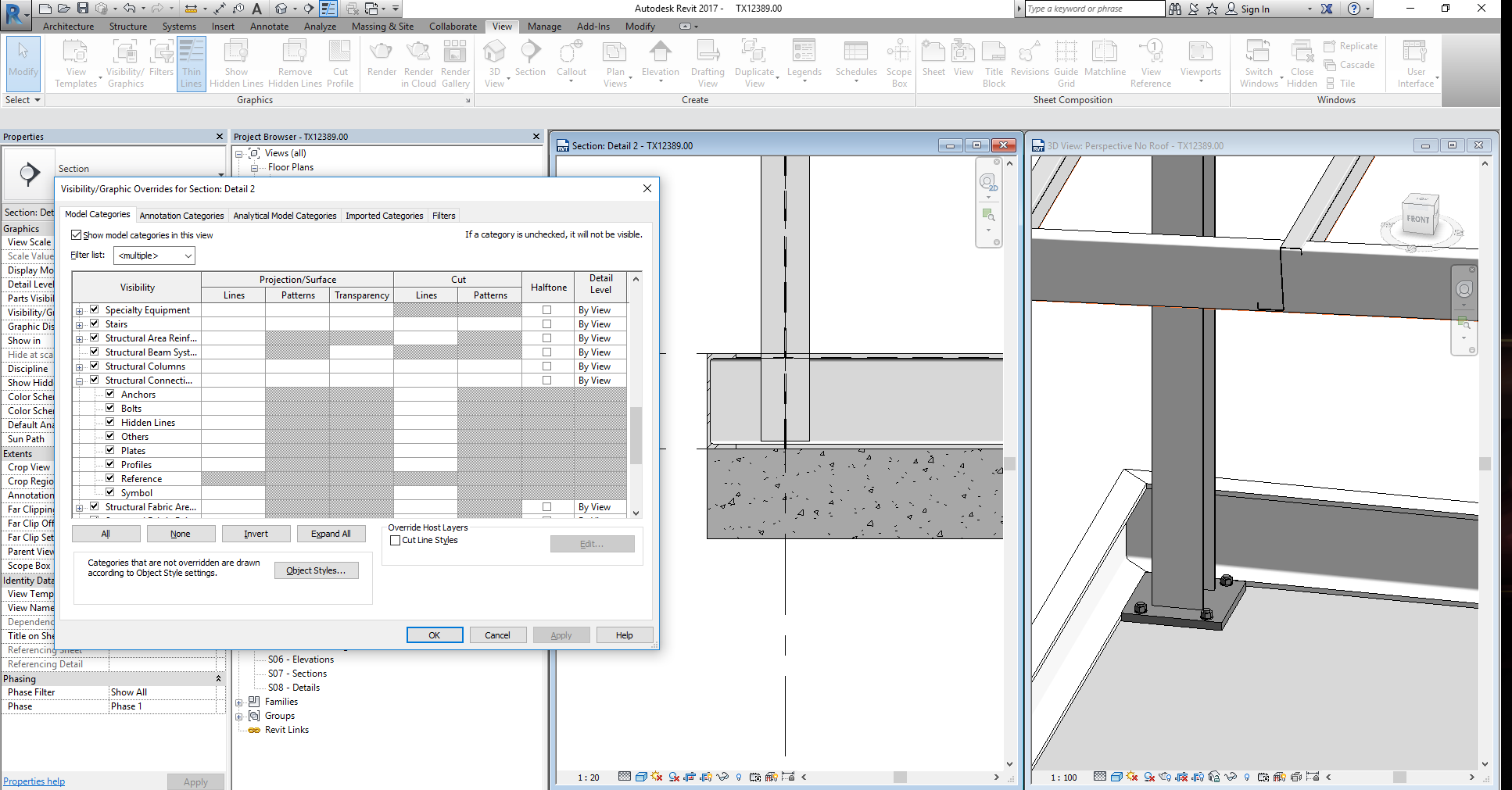

Howdy everyone,
Anyone shed some light on why the structural connection is not visible in the detail?
VG is all turned on and the phasing is the same, Connection is visible in Perpective but not detail
Please see attached
Cheers
Shawn

try to switch between detail levels , this is the problem probably , or it is the visibility settings inside the family geometry itself  look at that link

First thing that comes to mind is View Range.
Which 'level' is the floor plan call out detail taken from - and does the view range extend down to the level below if you have taken the callout from the level at top of the C channel ring beam ?

Tried both things, you cant change the visibilty settings in the family as it is a system family and there is no editable elemants,
I ended up deleting it and redoing the connection, somehow this has worked?
Teething problems with revit struture 2017 possibly?
