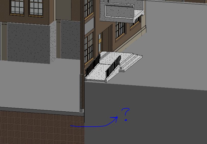

Hello,
For the life of me I can't figure out why the toposurface cut earth hatch is only appearing under the buildilng pad and not under the rest of the topography I created.  Any ideas?  See attached.  Thanks,
Jim

Is your Toposurface in EXISTING phase ?
i think your building pad being created in NEW phase considers the topo below as being 'modified' in the new phase, hence the earth hatch appears.

You are right, it was the phase.  Go figure.  Thanks!
