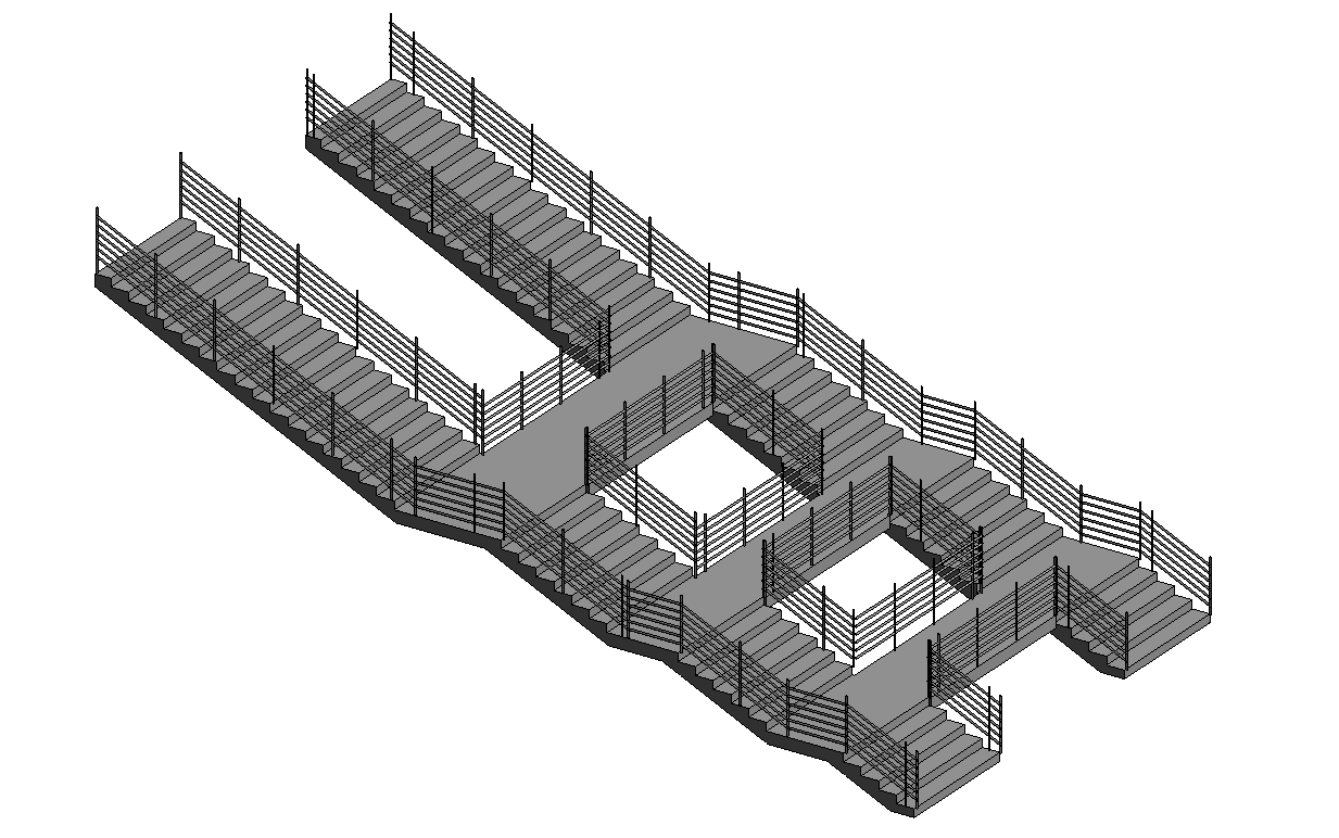

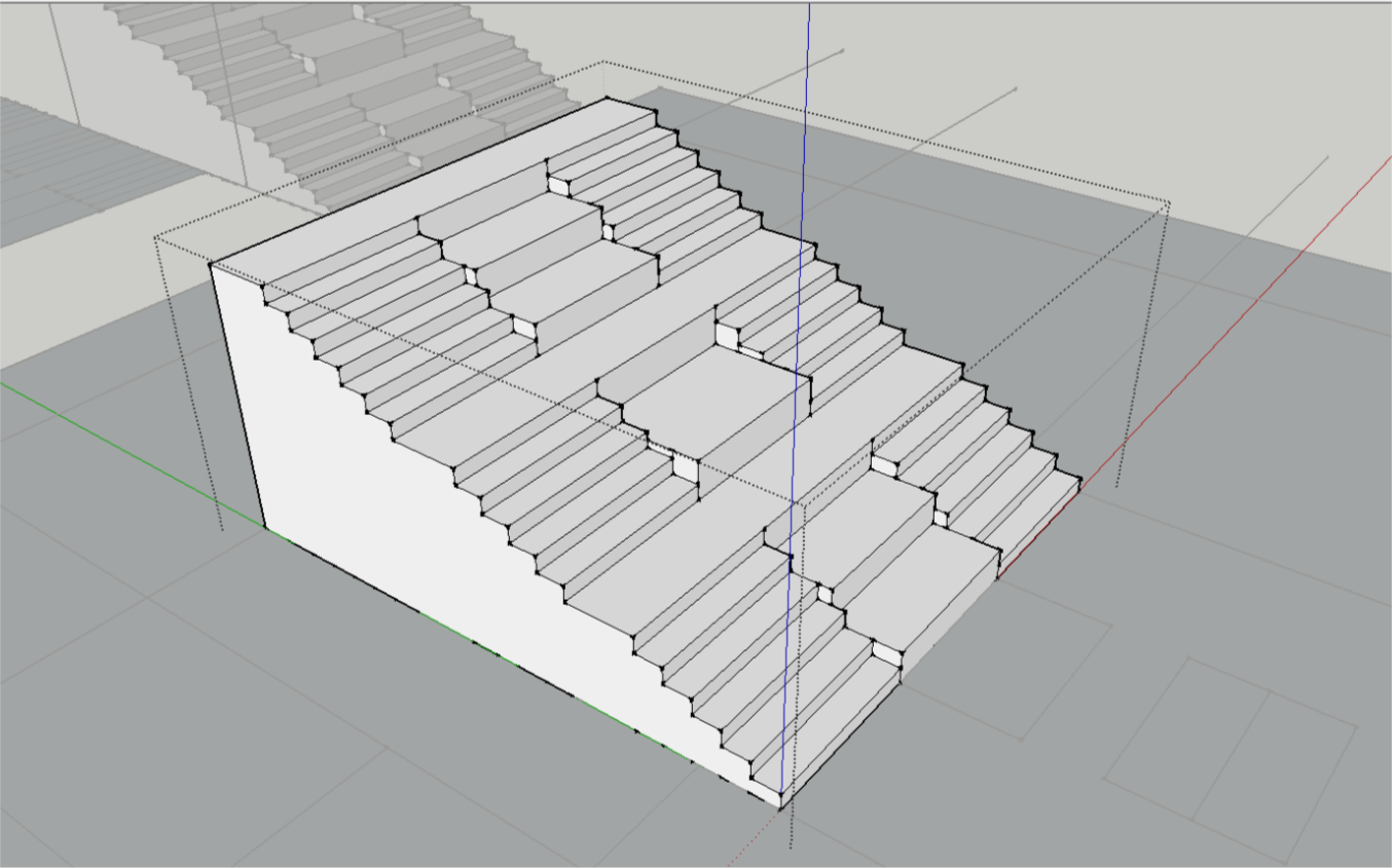

Hi, is there a possibility to create this kind of stair in Revit? I'm trying my best to use Monolithic stair to create this kind but i have no luck on making it. Thank you!

hello , the only thing thats not possible within the stair command is to have different riser heights within the same stair , so if i will do that stair i would do a double stair with the same landings and the middle part could be model in place or floors .

Oh, so i'm going to convert my Landing to do a double stairs? i see. That cleared up my mind. maybe I'll try creating the middle part in a new model. Thanks @Elnazer2 !
