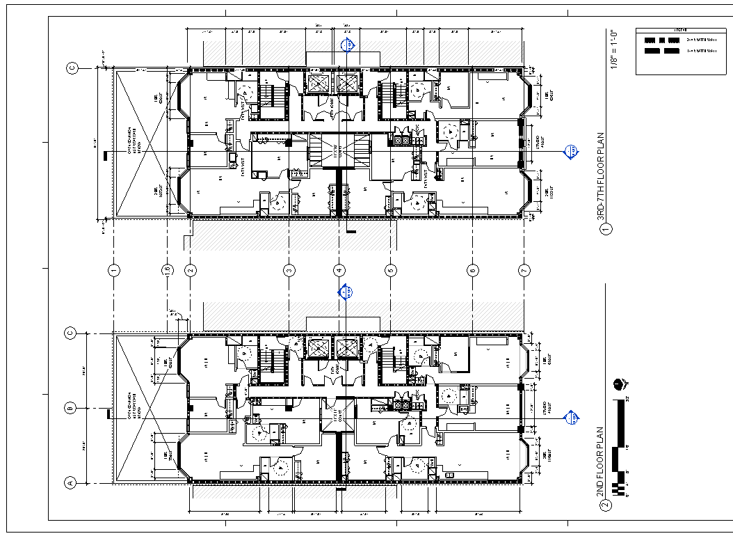

SIMPLE GRID - A, B, C, LONGITUDINAL LINES, 1-7 TRANSVERSE LINES, A&B WONT SHOW IN A FEW PLANS WHILE C REMAINS. SOME PLANS SHOW A B AND C. MY TRANSVERSE LINES HAVE STAYED CONSISTENT THROUGHOUT SHEETS, JUST A & B ARE MISSING. I'VE CHECKED MY VISIBILITY OPTIONS, CHECKED VIEW RANGE (ALTHOUGH I DON'T KNOW WHAT I COULD ALTER FOR IT TO HELP IN VIEW RANGE), I'VE CHECKED HIDDEN ELEMENTS, NOT THERE EITHER. JUST DISAPPEARED OFF THE FACE OF THE EARTH. PLEASE HELP, DEADLINE IN AN HOUR!!!!!!

have you checked the height of the grids in elevation or section if they are crossing the intended level or not ,

Usually i make a scope box that covers the building completely (in simple buildings). Then i select all relevant grids and in the properties of the grids i select that scope box. That should ensure that those gridlines are visible in all relevant plans and sections. This technique can also be used to make local gridlines for just some volume or floorplan creating local scope boxes.
