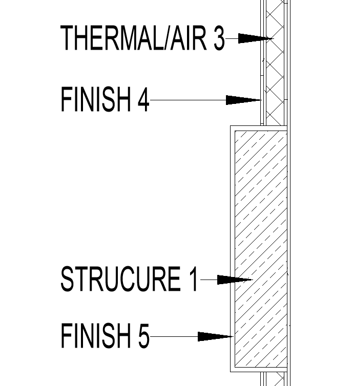

Hi.
I'm aware there were similiar questions but I could't find answer for that one.
These walls on the picture are joined but with the function "join", not at their "ends".
I'd want layers 3 and 4 to extend to layer 1.
I don't want to draw seperate wall as layer 5.
Any idea?

Do you fully understand layer functions?  Rea this: http://help.autodesk.com/view/RVT/2014/ENU/?guid=GUID-1CCD1005-CBDA-4338-8D60-489095D4BB25
I assume this is a plan view - you should state such.   The column is architectural / structural / in-place - What?

It's a plan.
Both are walls.
Digits are numbers corresponding with layers priorities.

Study the image in the HELP.
The center of tyhe upper wall should be a struture/core layer - priority 1, not a thermal layer.

No cause it's not. It's isolation. Then it joins incorrectly with floors layers.

Does the wall 1-5 have wrapping applied and it disappear when joined with 3-4, or walls don’t join properly? Is that what’s happening? I don’t think it will work the way you want it to then, not even with different/correct layers priority settings. Make 5 a separate wall and if you want 1 and 5 as one entity, group them. Using ‘disallow join’ wall setting, still will be necessary.

Or 'cut profile'.
