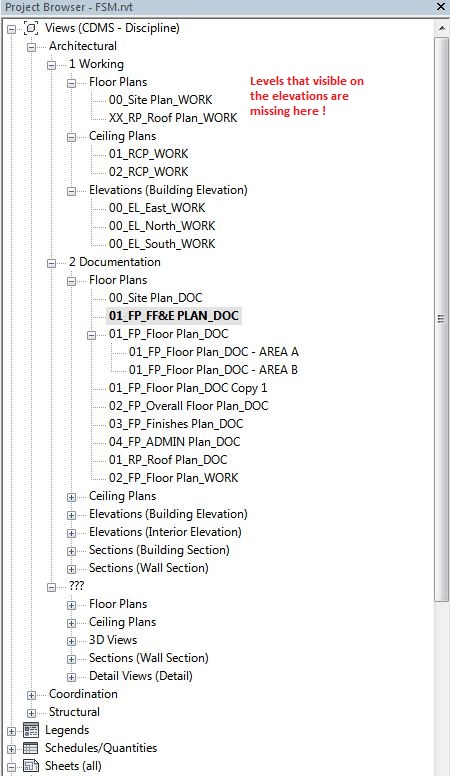

Hello guys,

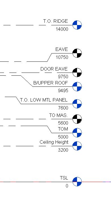

The attached image is from our designer drawing.
I could see all the levels in elevation. And all of them had been used in the drawing.
But in the project browser it shows different.
As per my knowlede If we change name of the level in elevation It would automatically update in the project browser isn't it?
Please help me to find out how it could have been done.
I would like to follow the same style as it looks well organized.
Please see the attached pictures.
Thanks.

i think to answer your querry there is 2 point on that :
1) The black label levels doesnt have plan views created with them and here  is a link explaining the difference briefly .
2)is that you need to be familiar with the browser organization and how it works and learn how to sort it and filter it if needed ( in this case i think your plans that you need are inside the "??" down your browser , here is a link from the autodesk help
Mon, Feb 6, 2017 at 10:28:42 AM | Elevation Levels are not matching with Project browser.
In addition, you can rename a level or plans independent of each other.   If the plan was created with the level, Revit will give you th option to rename the other (plan/level) when you rename a level/plan.

Thanks Elnazer2 & WWHub,
Your answers helped me really.
The link explained well.
