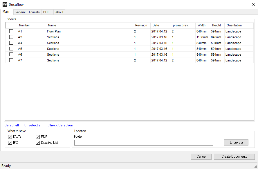

Please have a look on Docuflow; It prints sheets with different sizes and orientations (e.g. A1, A2, A3 / portrait, landscape) in 1 operation as you wish. This software is 65% faster than Bluebeam exporting PDFs and much simpler to use. For instance no longer requires to create manually paper sizes matching sheets in Revit. Also makes DWGs, IFC and drawing list in the same operation.
