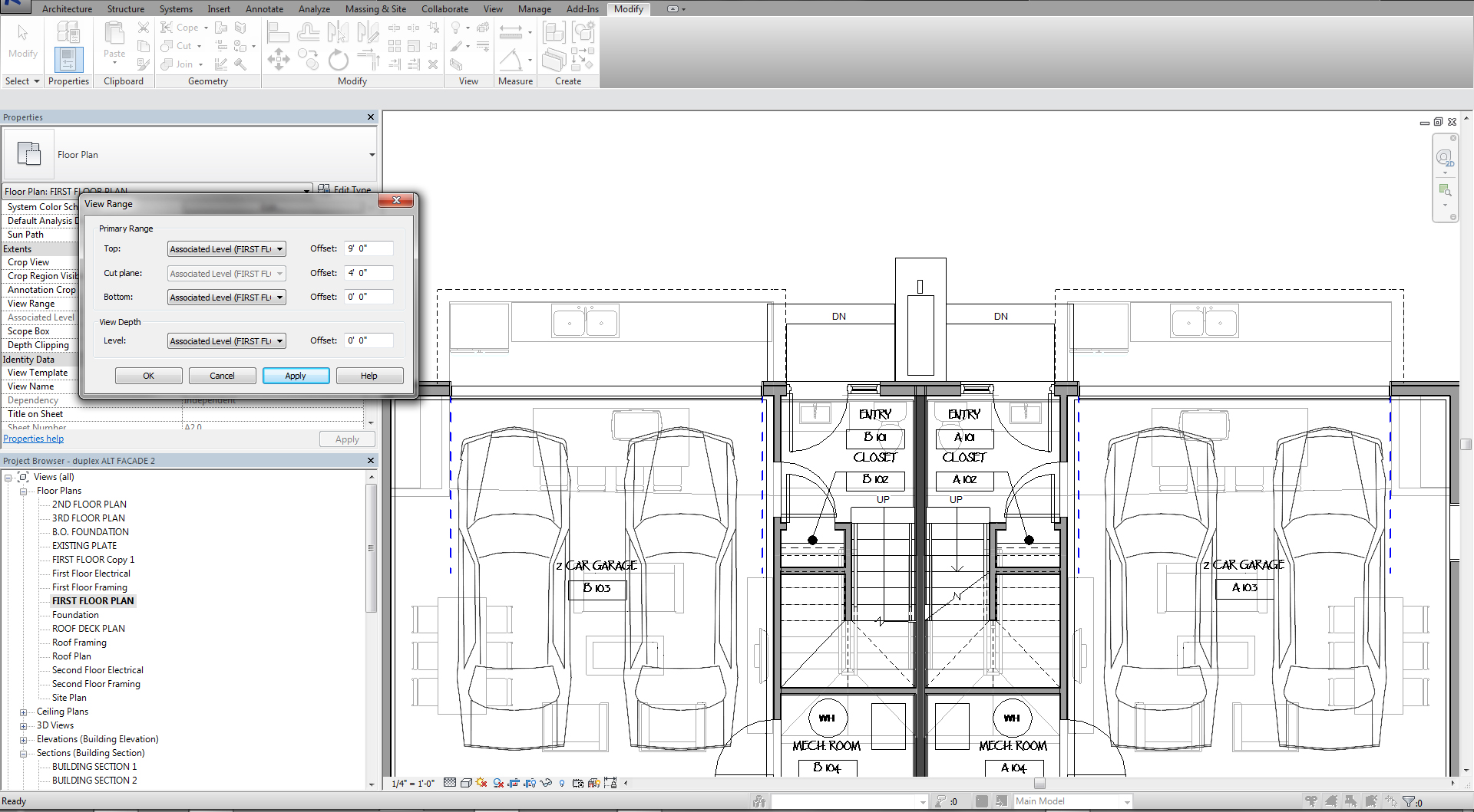

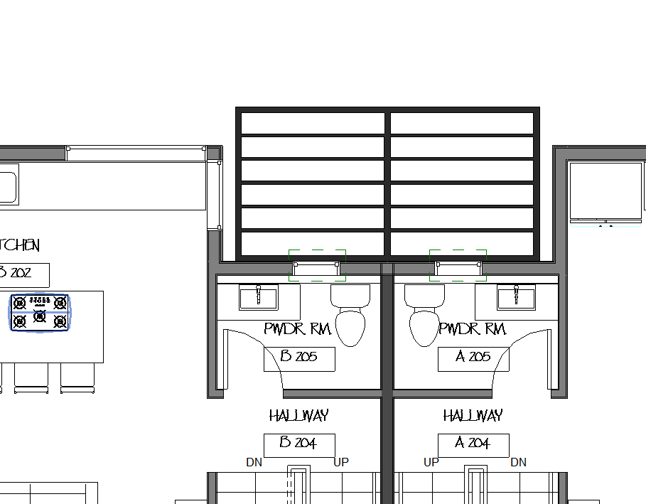

so i have canopy at 2nd floor level (image 1) that i need to show dashed in 1st level (IMAGE 2). while in 1st level view i select 2nd level asunderlay. thi thin is, canopy is not showing as underlay, so i can not use line work tool. as you can see on image 2, 2nd level overhangs on the side of canopy are showing as underlay and i was able to use line work tool to show them dashed. so how do i get the canopy to show? while playing with ranges, if i set 1st floor cut plane to 0, canopy will show. however if i use line work tool now to make dashed outline and then set my 1st level cut plane back to 4' i can no longer see dashed outline. any ideas?

image 1 showing 2nf\d floor canopy

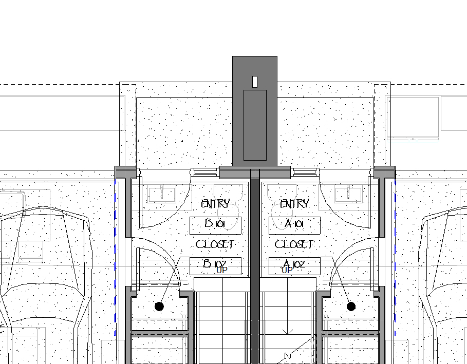

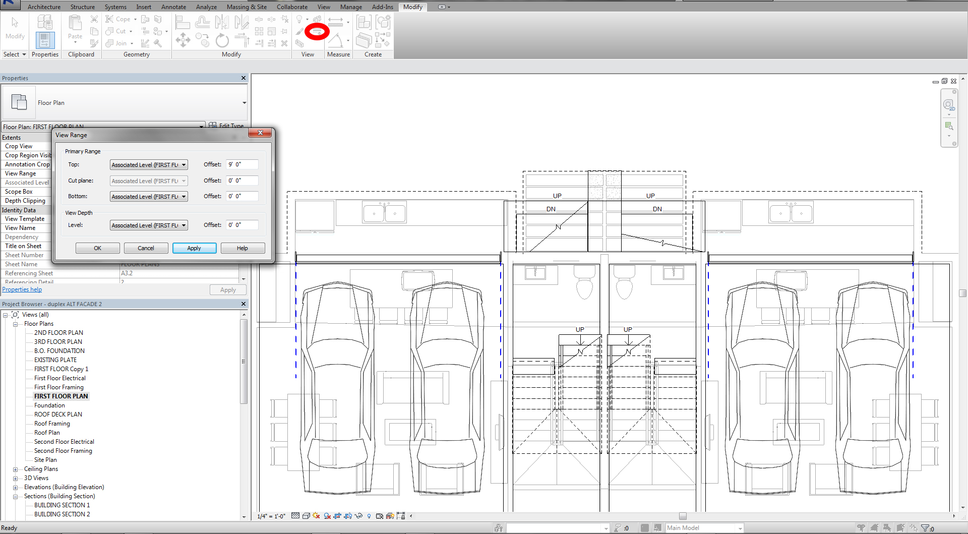

WWHup, i believe i am using proper technique. please look at attached images. 1st one shows my cut plane set to 0. you can see overlayed canopy in the middle, i already used line work tool (circled in red) to show its outline dashed. all good so far, except i need sut plane at 4' or so. so 2nd image shows cut plane at 4', as you can see both overlayed canopy and my dashed outline is gone. lnot sure what am i doing wrong here, i have used this technique before, althought not on above canopy.
i guess my other question is why canopy overlay shows only while cut plane is st to 0? just trying to find some logic behind this.

used 2d line for outline. wouldnt work. what i finally did is i erased my canopy and re-drew. now it shows as underlay with my cut plane at 4' so i can tag it with linework tool. maybe i messed up something creating it the firs time.
