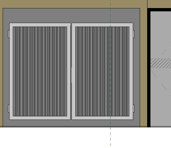

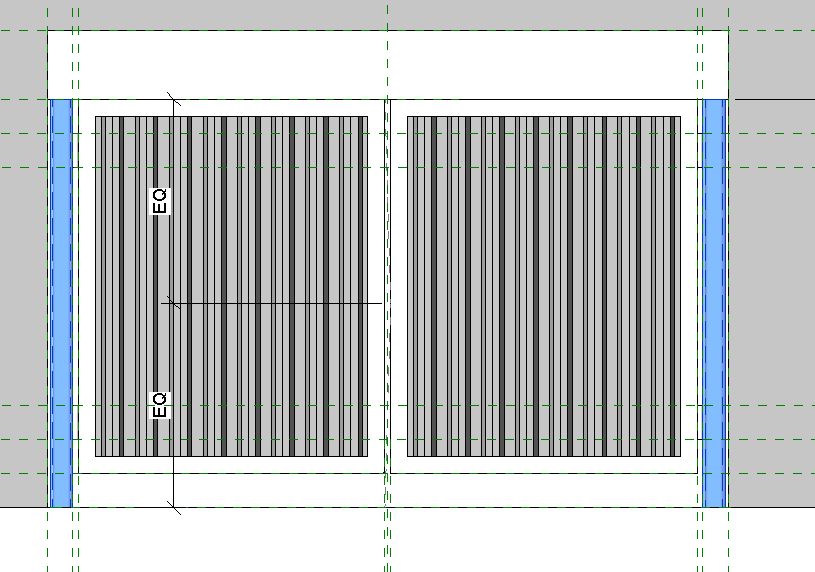

The problem is that the two side posts do not show up in my elevation. I want them to show. I have checked the VG in the family. There is no issue there. Any help will be appreciated.

Set your detail level to medium or fine.
