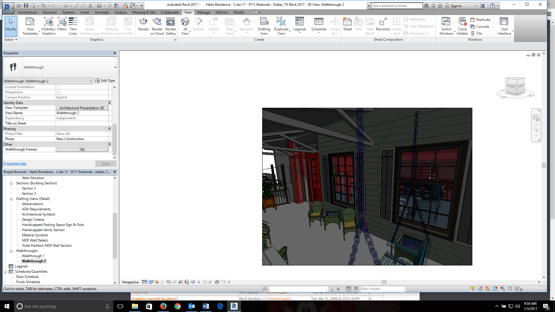

The default is "Show All".  I have some demo walls that are showing up in red that I don't want to see.  I would like to change the phase filter to "Previous + New."  Anyone know how?

Just click on the Walkthrough in your project browser then in the properties at the bottom under phasing you can change your Phase Filter and Phase.

Here is the print screen showing the phase filter "grayed out" on the property box, if I followed your instructions correctly.

You have a view template assigned to this.
Also, what were the settings of the view you created the path on.

So, you are saying the walk through defaults to the original plan "view settings" and changing it in the walk through properties is not possible? Or are you saying that if there is no view template assigned then you can reset the phase filter in the walk through properties box?
Tue, Jan 3, 2017 at 11:07:39 AM | R-17 Wanting to change the phase filter setting in a Walk Through......
I don't have Revit here to check it out but you do..... why not look at thatview template you have assigned to this first?  So easy to do....
