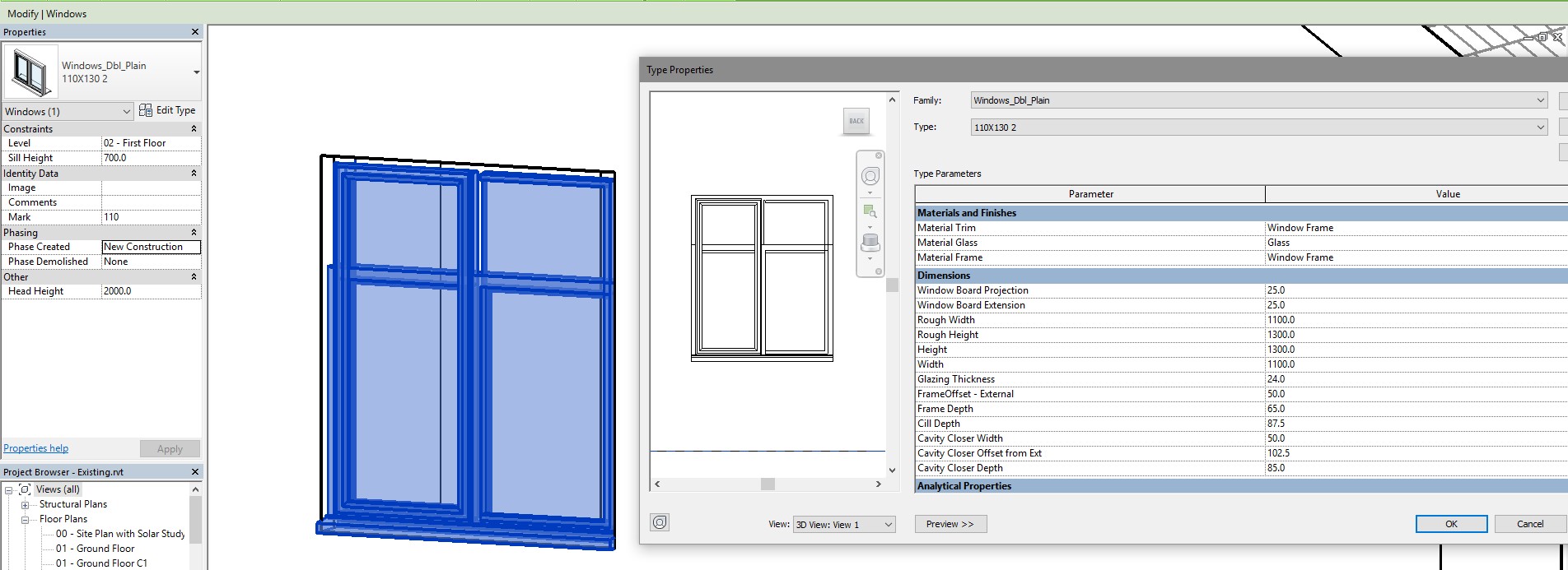

I've been having a problem with manipulating the windows height. When I change the height, the panels change height, but the window frame stays constant. Can you help me with this?
See picture. This should be a double plain.

Fixed it!For anyone having this problem > You need to go and edit the family. Apparanty the frame constraint was unlocked. You need to set it up and lock it.
