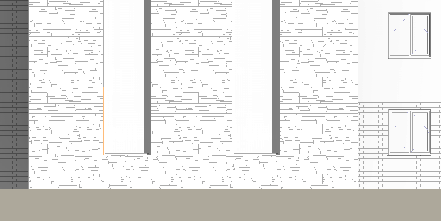

I'm not sure what i'm doing wrong, i've been working way on this issue for the last 3 hours! I've got a basic cavity wall, i'm trying to use the split face tool, i selected the correct plane and the orange boundaries display, however if i create a complete closed lopp within the boundaries, the split face works fine. If i draw a line from boundary to boundary (orange line to orange line), the line is create but the face isn't actually split!

1.) Split Face- i was trying to split in perspective, but i have just tried again in elevation, and whilst i see a vertical line (my split line), when I go to select the wall, it is still all one module. Using RV15. Just done a quick screen shot where you can see my split line and also note that it has failed to split.

You are at an opening!  Move the line to the left off of the opening and you will see that it works.   The opening is considered and edge so you need one line at the top and another at the bottom.   Turn off the window to see what I am talking about.

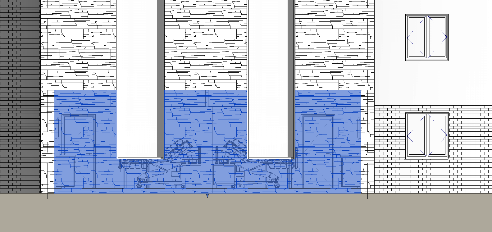

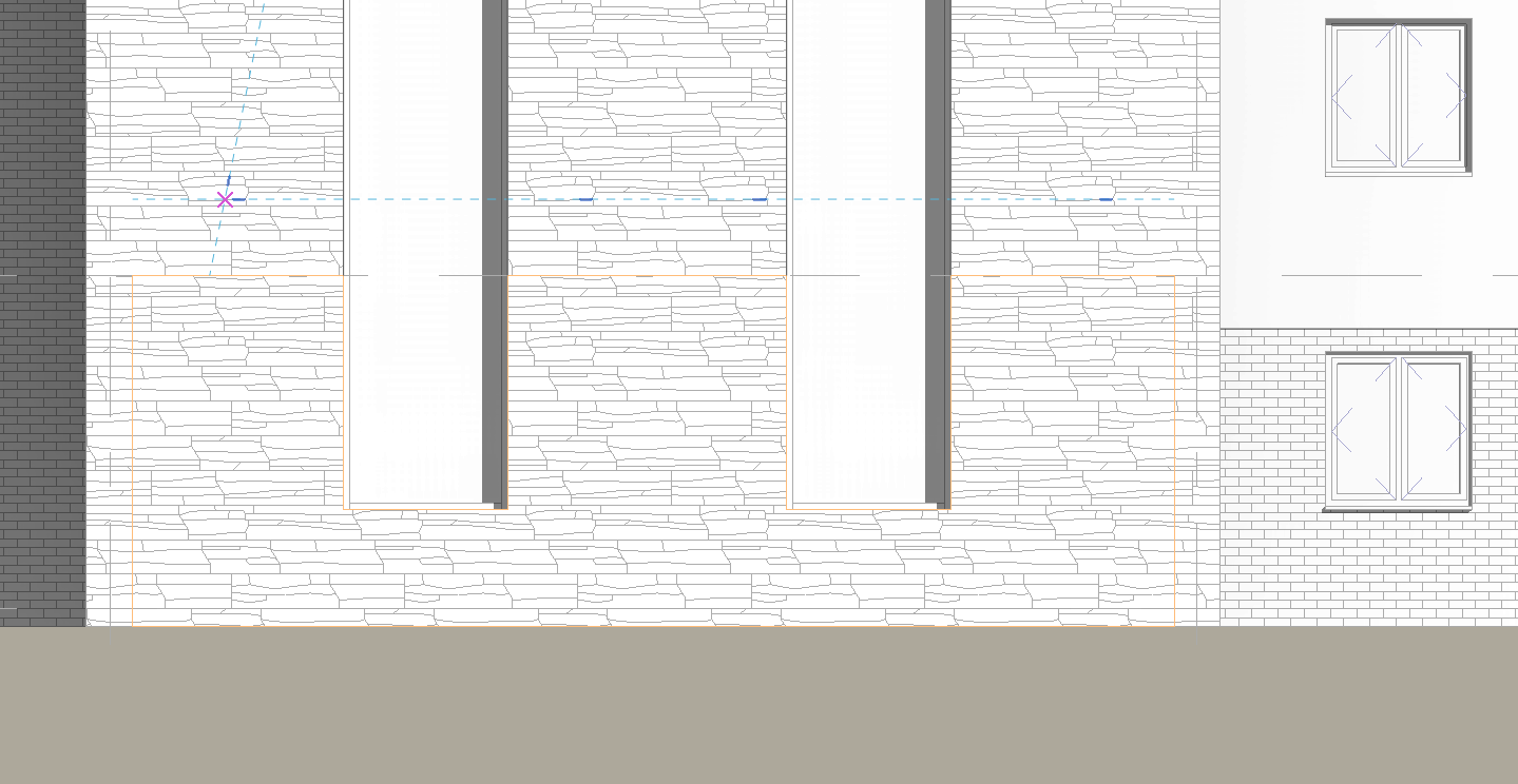

I'll show another example below. Image one shows the orange boundary, Image 2 shows the pink link as my split face line. Once i click the green tick, and try and apply a paint to the face to either side, it just selects the entire wall as shown in image 3.

I have used split face for years, all the way through 2016, and never had a problem.  So there is something else going on here.   I asked what Revit and what updates but you did not say.  On occasion, some issues have problems but we can't help you with that.
Try isolating the wall in view, then splitface.
Why do you say the face is not split?   Is there a line after you finish the splitface?

I'm so frustrated with myself- i've sussed it out! i can't believe it took me a whole day at it too! Basically, the split face was being created, it was an issue with paint. My paint toolbox is quite large, and so i was selecting the material and pressing "done" thinking the material was selected for use. However, it's transpied that the toolbox has to remain open whilst i'm selecting the split face on the drg (before pressing done!) Glad i got to the bottom of this one! thanks anyway for your help.
