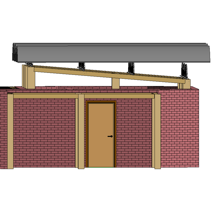

Hi, i am creating a roof that is arched and sloping downwards. I have made the roof by extrusion, but dont know how to make it slope downwards! anyone got any tips? thanks!

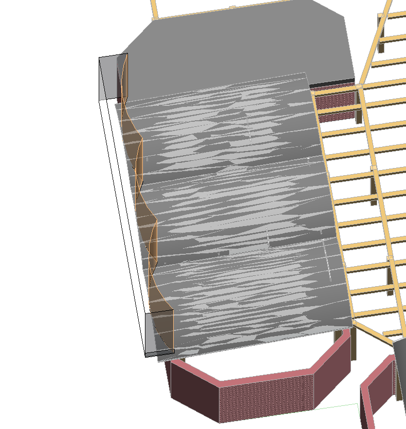

@raja15 thanks so your reply! that worked out fine Smile now i want to cut a scallop edge on the roof, would you by any chance know how?? tried googling it, and tries cutting it with a mass but i dont think i did it right! here is a picture showing what i want to do:

I would use swept blend to create this roof and I would cut it to shape that is needed with a void extrusion. Blend might be easier to handle than a mass.
