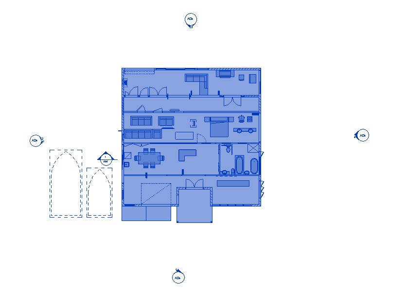

Quick question, when rotating a 3D house (hypothetically), you select all 3D elements, and then in a plan view, rotate to the degree required. Sounds easy enough.

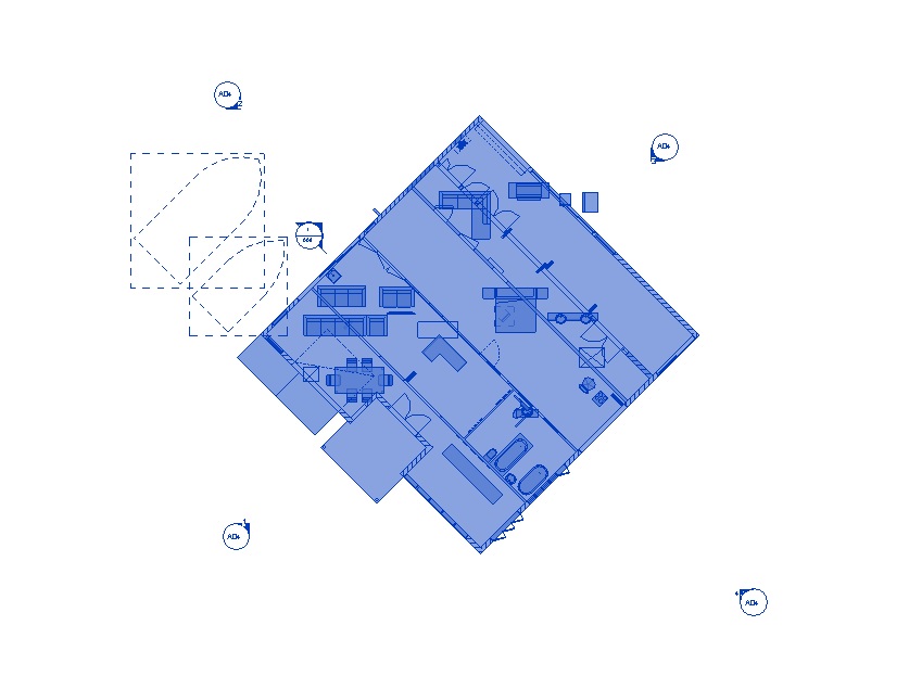

My question is, why do some elements not rotate despite being selected as part of the rotating process? Refer to my screenshots for before and after rotating. I have only rotated 45º but you will see in the "After" screenshot, the elements which did not rotate.
Is there a simple fix to this in the family properties, like a tick box or something that I'm not aware of?
Some of these families are wall based, so I can understand that they rotate, and that is proven in my exercise.
However for example: "Plumbing Fixtures"
The 2 bath families
 - One freestanding
 - One Built-in
Both of these families are not wall based, yet rotate with the rest of the elements
The 2 basin families
 - One single vanity
 - One double vanity
Both of these families are not wall based and do not rotate with the rest of the elements.
Most of these families have been created from scratch, and some have been downloaded from the RevitCity download content, and modified as required.
Any help or advice would be appreicated.
Thanks in advance.

In this instance it is not the Project North we want to rotate. I have found that when I select all the elements which do not rotate, and rotate them separately it works.
Just can't work out why as a whole, all these 3D elements do not all rotate with each other.

EDIT: Not sure why I was having this problem, but I created new families & copied in the 3D modelling for each family not rotating, re-loaded into project and now it rotates with the rest of the 3D.
Edited on: Tue, Dec 6, 2016 at 10:11:41 PM
Tue, Dec 6, 2016 at 10:43:17 PM | Rotating 3D Elements all at once
raja15
Joined: Mon, Feb 21, 2011
84 Posts
5 Stars: 1 Votes
Update on my previous edited post:
The families which have dimension parameters to adjust sizing etc, are the ones which are not rotating with the rest of the 3D.
Are there any properties when setting up dimension parameters which affect families when loaded into a project?

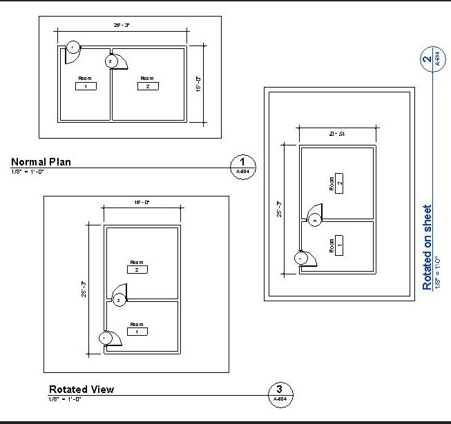

First question is, what are you really trying to do - not your process?
Did you know that you can rotate a view?
  1. First method is rotate a view on a sheet.  Everything turns on the sheet including text and title.
  2. Second method is simply rotating the view.  Turn on the crop region, select it, then rotate it.  This turns the view but all annotations remain as normal to the view.  They do not rotate with the view (except dimensions).
Look at the attached image to show the choices.
If the building needs to rotate in relationship to the site but project north remains the same, simply rotate the site!
And finally, there are the rotate north, rotate project north and yse - choose the elements and rotate them.  << I really don't think you want this last choice.

Thanks for your feedback archigrafix. I tried what you mentioned about placing into a separate workspace & rotating and that didn't work. However, when I grouped all the 3D elements together into a model group, then rotated, everything rotated fine.
I'll just have to remember to un-group the elements when finished, and delete the model group from the project browser.
