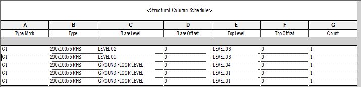

If I have read your desciption correctly, I have created a very simple Schedule of Structural Columns using the following Feilds:
Type Mark
Type
Base Level
Base Offset
Top Level
Top Offset
Count

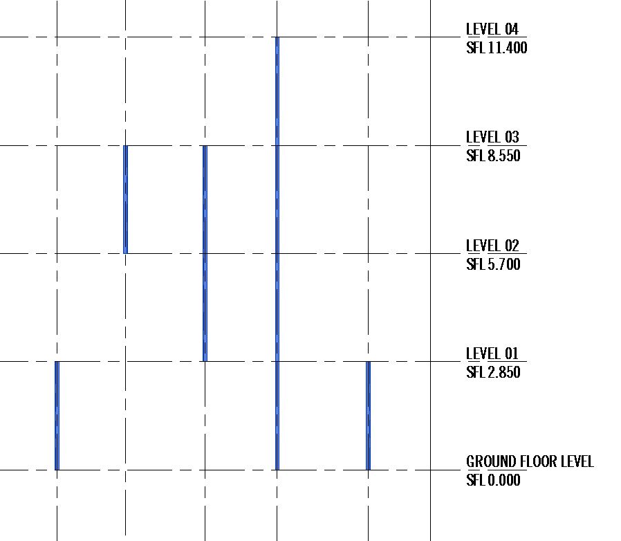

I then Placed 5 columns with different start points (base) and different top points with the resulant table.
you can add other standard fields like Length and Mark if needed.
All the Fields are standard fields available for the Category of Structural Columns - I didnt create any custom parameters.
I hope this may be of help
(example taken from Revit 2015 - because i had it open at the time)
