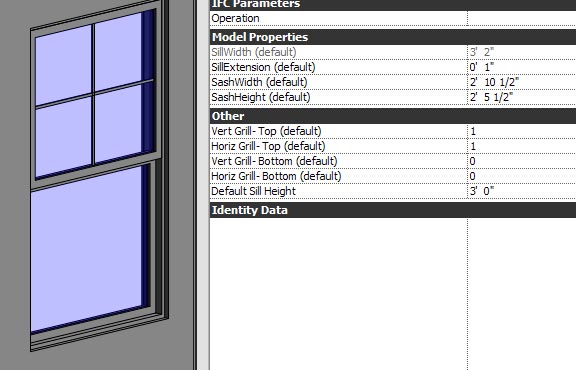

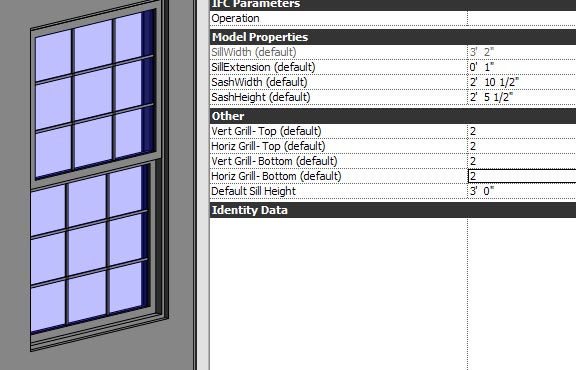

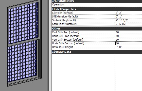

A user on here posted these images a few years ago, but never gave an explanation. Does anyone else know how to do this? Thanks!
Mon, Nov 28, 2016 at 12:30:49 PM | How to nest a mullion array family into a window sash
You can open a commercial window family found on seek and learn by looking it that..
