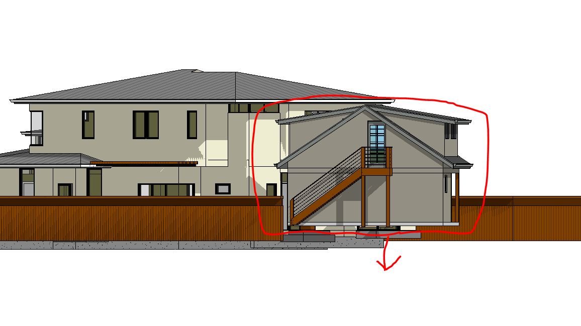

So I linked in a detached garage model to my main house model. But I can't figure out how to adjust the elevation of the model, as you can see in the pic, its floating above the first floor area a lot.
Any advice?

Links work similar to groups.   You can just selec t it and move it.

Go to a section or elevation, select the link and then move it up to where you want it. You can then save position/publish the new coordinates back to the link so it knows where its new position is.

HI. nether option worked. the linked model will not move in section or elevation. it only moves left or right.

Then someone placed a dimension lock to a level.
Does this linked model have levels?   If so then maybe the first floor level is locked to the host floor level.  If that was done with a dimension that is now missing, you should be able to move it detached. I sometimes remove dimension locks by adding the dimension, locking it then unlock it.
