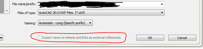

I think what he means is the views and titleblocks and other things on a revit sheet are seperate links within the dxf. When you export to dwg you have the option when saving the file to uncheck a box which to have all those things as xrefs and links or not (see image). When going to dxf this is greyed out. Might want to export to dwg first and then to dxf.
