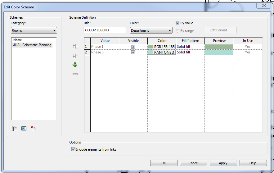

I'm in the process of creating a colored schematic floor plan and cannot delete or edit a pre-existing "Department" value.  It says it is in use, though I cannot find where or with what.  I created a room schedule and there is no room with a department value selected.  Does anyone know how to find where they are "in use"?  I need to add more values to this and don't mind just re-using them, but it won't even let me edit the name.  Does anyone know how to rename the "Phase 1" and "Phase 3" so that when I put in the legend I don't have these random values that won't exist on the plans I'm creating?

just as a wild guess do you have any linked revit files ? that could be the reason
