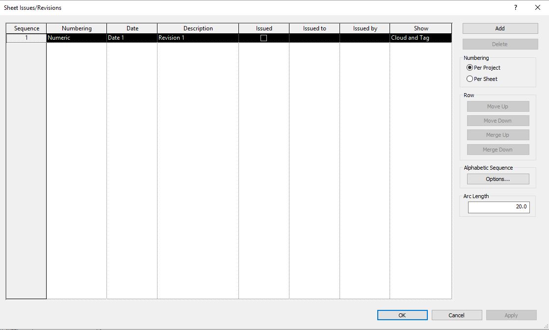

Hey guys.
I'm having a bit of a problem with Revit 2016 now, that I've not seen before.
A coworker is creating Per Sheet revisions, as she has done hundreds of times before, but all of a sudden now they apply to more than one / all sheets. There has been no change to the central model or her computer or her Revit since a couple of weeks ago when this was working just fine.
It's most strange. I've tried it myself, and I create a new Per Sheet revision that's only supposed to be on one sheet, but when I go to another sheet the same revision appears there. Likewise, deleting the revision from the one sheet deletes it from the other sheet.
I don't have any idea what I could possibly be missing, so I'm hoping someone here could point me in the right direction.
Mon, Jan 30, 2017 at 11:35:48 PM | Per sheet revisions don't stay on one sheet
DavidBruinsma
Joined: Sun, Jun 3, 2012
13 Posts
5 Stars: 1 Votes
Hi ArniVidar
It could be that the Numbering has been changed to be Per Project, instead of Per Sheet
unchecking 'greyed out' revisions on sheet
