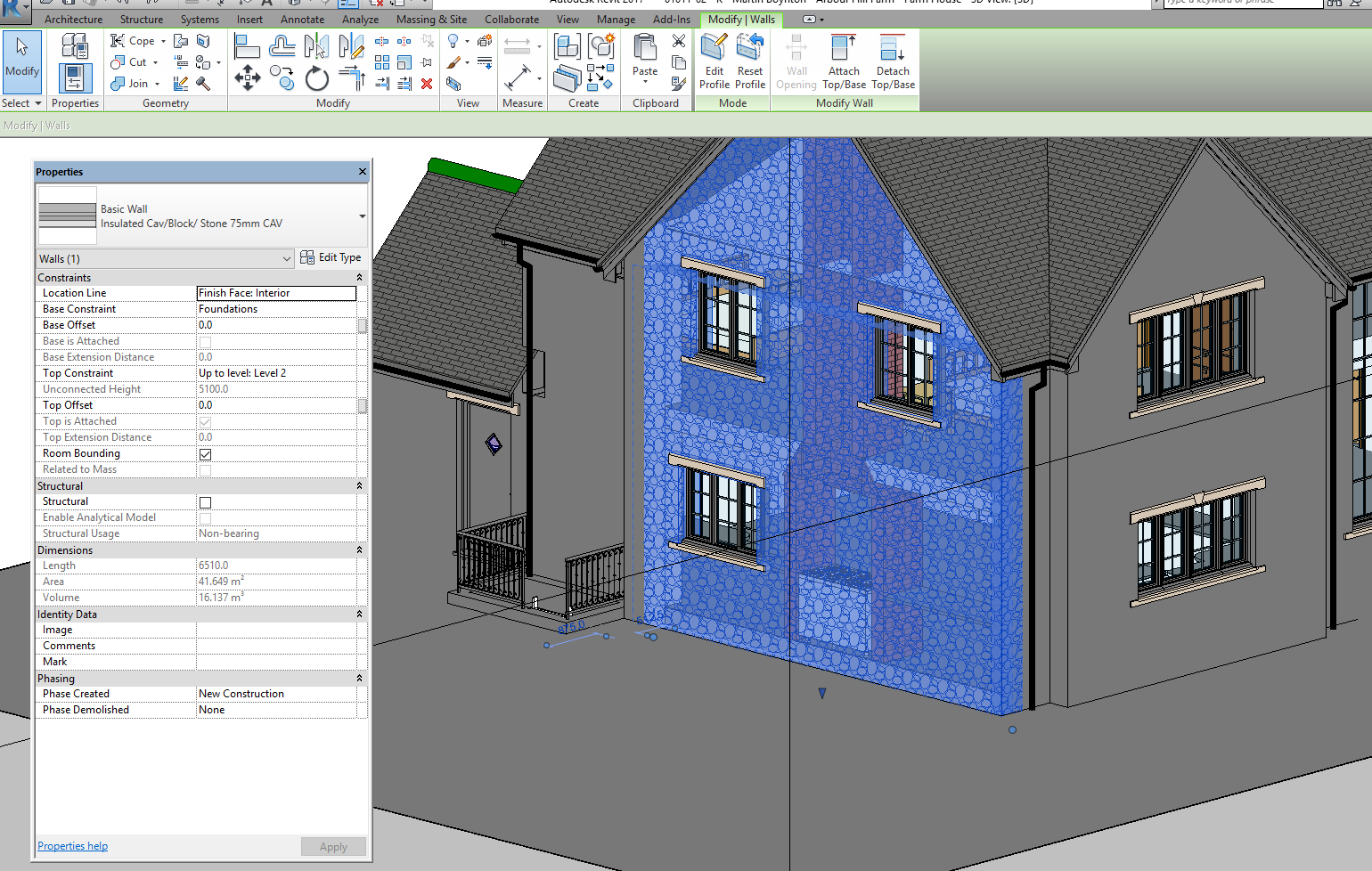

A couple of walls that have openings in such as doors and windows wont show up in section, ive done all the basic checks e.g. checked the VG and to see if they are hidden but they are not.
Can someone please advise me.

Thanks for you reply, but its not the openings im having problem with its the wall itself, im not using phasing for this perticular job, everying is on new construction, my problem is that the wall will not show up in sections that cut through windows and doors, any ideas on how to sort.
Many thanks

WW Please find attached.
As you can see in the images there should be a wall above and below the window.

OK... I see a wall below so probably not VG but it could be phases even though you say you are not using them.   Just a click away.
Could this wall be on a different workset that is off?
Always list what Revit and Updates you have installed.    There are issues that are associated with releases although I don't know of any like this.

Post a little 3D image and the properties of the wall.  The wall is continuous, there is not a seperate little wall under the window, correct?

WW, please find attached, you are correct it is just one wall.
Tue, Nov 8, 2016 at 7:43:36 AM | Walls wont show in section.
#10
I see no reason for this issue.   I'm not on 2017 yet
I see 2017 has two updates - you don't sy if you have them installed.

Checking for updates now, i tried a wall with windows and door in a seperate project and it works on that, its just completely weird.
Tue, Nov 8, 2016 at 9:35:46 AM | Walls wont show in section.
#12
There are times when a file becomes corrupted but this may be an update issue if you haven't updated at all.   You can always check what you have installed in the ? dropdown - about.

It works in other drawings, so im just gonna region the wall in this one, thanks for all your time and effort.
Is there a way to force walls to show section?
