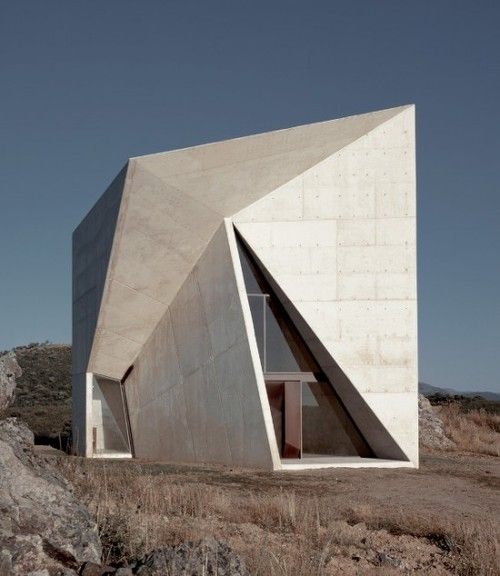

I'm trying to create a building similar to the one in the picture I've attached. What is the best way to create these faceted walls?

2 ways:
- In project use "Modeling in-place" - category WALLS
or
- Goto "Conceptual Mass" - create the form then in project Apply "Walls by Face".
