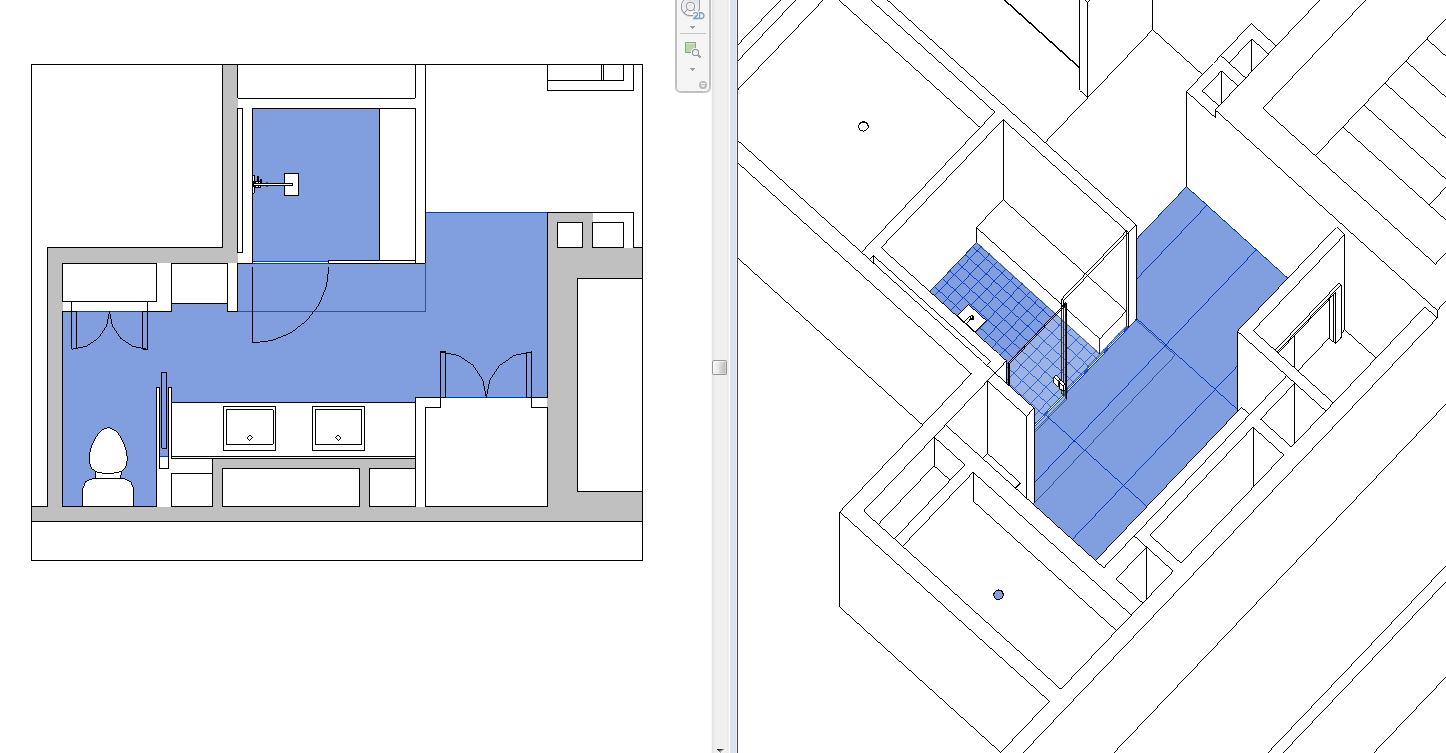

Hello - hoping someone can help. I have created a new floor type and assaigned a material to it with a model surface pattern. It shows up in the 3D view, but not in the floor plan. I have checked VG overrides, worksets, view range and even tried painting it. Nothing worked. Anything I am missing? Thanks for any ideas!

More than 99% chance that you have done something to create this problem.   Look again at your plan settings for cut plane and also at your VG settings.  Is there a plan region? You might create a new plan of the same floor without any template from the plan dropdown.   Don't copy your plan - make new.  Cut a section and make sure something is not hiding like another floor or layer.
Something is strange in your views.   In the 3D, I see what must be 2 different floors but they are both blue and I see a blue limit line in the larger area.   What is what?

Any filter applied to the view, or overrride graphics by element?

still no luck... made a new plan, checked for hidden objects in section. im at a loss. very odd b/c the floor outline shows up in plan, but not the surface pattern.
I had two different types of floors highlighted in blue in the image i sent.

double checked and no filters or overrides

Can you delete everything but floors, purge and upload, so we can troubleshoot?

if you are using phasing check the phasing overrides
