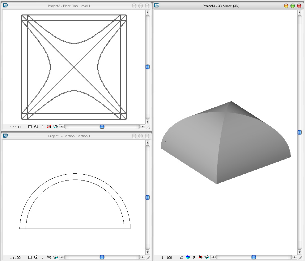

I am having some trouble drawing a dome roof. The trouble is that it is a dome that is square in plan. Imagine a dome that tapers down to meet a the corners of a square structure. Does this sound impossible to model in Revit? Thanks a bucket.

Is this sort of what you're after?

Yes, Well very similar anyway. the top should be spherical. Like a dome but this would be close enough. Can you fillet the edges where the egdes meet aswell? Cheers

You could easily sweep another void along the edges to smooth it off a bit, i was just keeping it simple and reducing the number of lines. Its created as a mass and consists of two sweep solids and two sweep voids. All very simple arcs. Let me know if you want the file.

Mr Spot, Thanks, I tried this approach but I still wanted a spherical top. With some help from my teacher I have revolved a dome so the leading edge meets the very corner of where the walls meet. Then placed a void to cut the over hang from the outside face. From here I'll just attach the walls to the dome. It's a simple approach and it's not spot on but it might have to do. I'll attach a JPEG when I work out how.

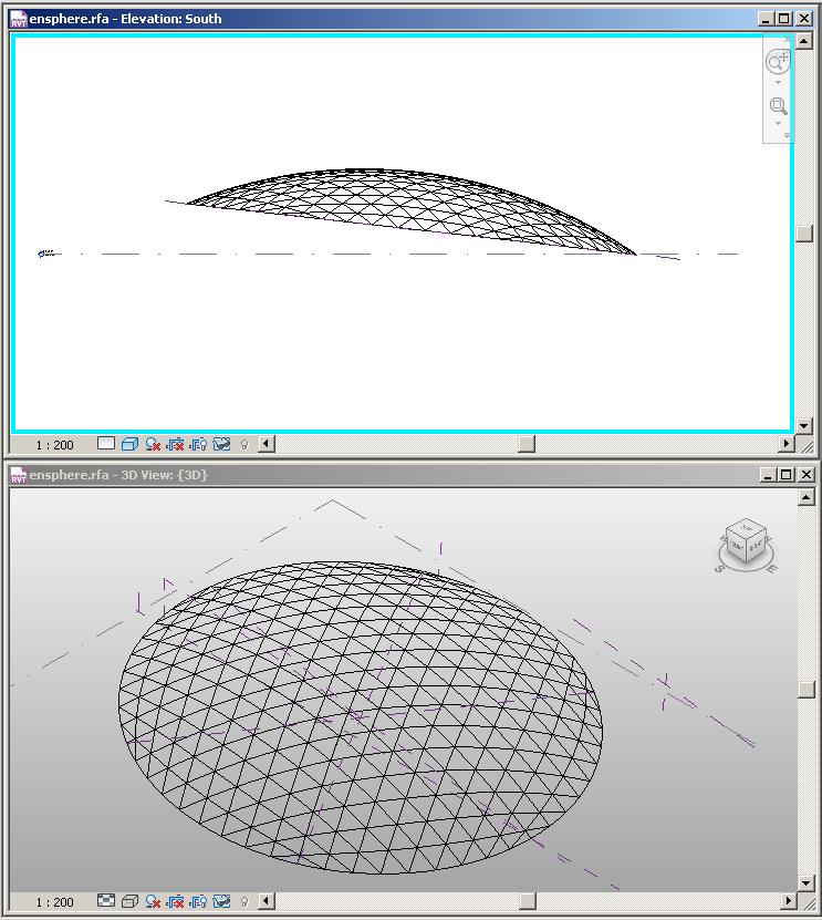

I have a dome structure we started to design.  I had to do the main layout in AutoCAD then create a mass object in Revit to start the beam layout.  Unfortunately Revit does not like to place objects out in space, especially when there are not parallel to a floor plan.

For something like that, i would rotate the dome back to my xy plane - create what i had to, then roatate everything back.

Tried that.  unfortunately Revit does not like to rotate beams and columns.  They tend to move all over the place.

Are you really using (structural) beams or just beam like objects?  Although structural elements can be a problem, components created in place will rotate just fine.

Creating  nearly 160 work planes so I can create a In-place object would nearly be imposable to do accurately.   I am trying to create a model that a structural engineer can use to correctly size the beams and connection plates.  See the DWF file for a better illustration.

I think your missing the power of Revit.  You need to do something like Mr. Spot did here: http://blog.cadway.com.au/
