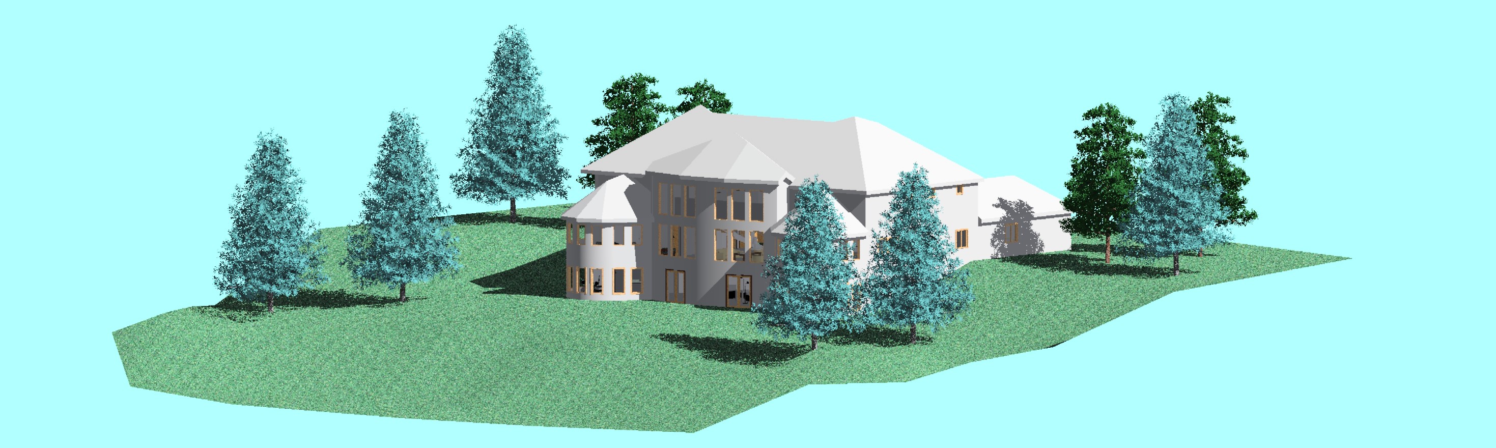

There is a grey plane that is almost like a floor. on the outside fof my house. How do I get it to lower so that I don't see the grey but I do see my grass?

They grey plane is most likely a "ground plane" Ground planes are useful if you don't have a site plan and just want a meterial to appear in your rendering at a certain level.
To get rid of the ground plane yu have to check in two places:
Settings>Sun and Shadow Settings [un-check 'ground plane']
And:
Rendering TAB>Settings>Environment [un-check 'ground plane']
Why there are two places for ground plane I haven't figured out yet. Hopefully this will clear up your problem.

That's the one I was forgetting. The Sun and Shade settings. Also, played with your model. It may have just been that my default settings kicked in when it upgraded the file to 9.0, but i did not have a ground plane in my rendering. Also, all i had to do was relink the trees with the correct library location and they rendered fine. Hope this helps at least a little bit.
