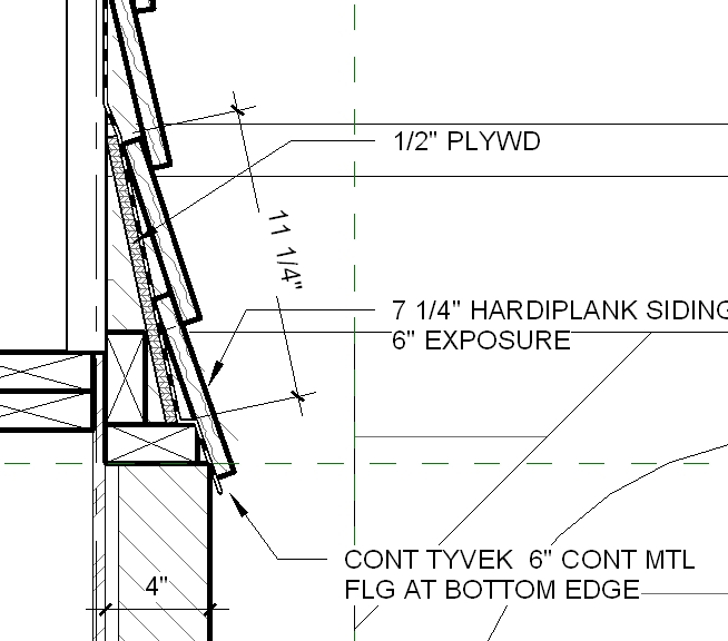

See the JPG. Here is a way to create a readable overaly linetype for detailing... make a linetype "DDD" that is black and lineweight=5 and and Line type "DD" of weight=3 that is dashed and color=white. Draw the DDD line, copy it, change it to linetype DD and paste it back on itself. Might be useful for you.

ps... it's the line that is labeled "tyvek"

Good tip Steve. I like the difference in line wieghts, giving a border to the white fill. I will definitely find a use for this. Post edited on 2006-05-07 04:17:59

I would like to see Revit have some sort of 'mline" like autocad. This comes close.
