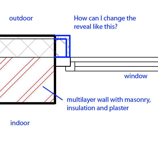

we have some problems with the position of the layers in a multi-layer wall in the reveal of a window. can you help us to change the postion like in the picture of the attachment

2 issues here first you need to look at "wrapping" when editing the wall structure you can set wrapping behaviour for "inserts" (windows & doors) and "ends". Any layers outside the core are able to wrap. Second part involves family editor and setting up the "cut extrusion" in your window family so that it forms a rebated jamb. I've never actually needed this, but once you get into family editor and work out how to lock things onto reference planes you can usually find a way to achieve what you need.
