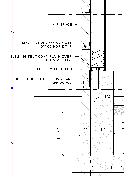

You can also modify the wall type to allow stretching the outer layer of material. edit wall -> edit struture -> preview ->modify then zoom in to the bottom or top & hover over the bottom edge of the outer wall layer and toggle "lock" the layer you want to stretch and everything else unlock. You may have to zoom way in for this lock icon to appear. I am not sure what the logic is to which wall layers are locked or unlocked but lock the layer you want to stretch and unlock all others. lt has to match locked states at the top of the wall too (i think). Then in a section you can just stretch these up and down, like the masonry in the jpg.
