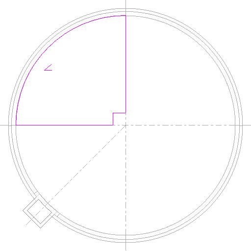

I am trying to slope a slab with a radius edge. If you look at the attached file, I need the radius edge to be constant and then for the slab to slope at a constant pitch to the center of the arc. I've tried using a slope arrow, but the radial line doesn't stay at a constant elevation. When I try saying that the radial line defines the slope, I get an error message when I try to finish the sketch, but the message doesn't give me any help, just "Error 1". Does anyone have any suggestions?

I would use an inplace floor family with a solid revolve and a void extrusion to cut the center square. I've attached my version of it for you to look at. HTH Tom

Thanks Tom, I think that'll work. I just need to get more practice on in place modeling. It looks like tonight will be a good time to get started.
