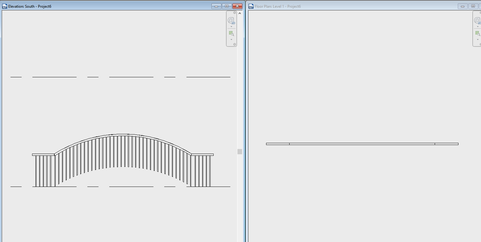

Hi,
Does anyone know how to place a railing on a sloped/curved surface (in elevation)?
I have tried to host it on my specially modelled generic floor, but it would not let me... Why is the railing function in revit so limited Sad
Im using Revit 2015.
Greatful for all help.
Fri, Oct 21, 2016 at 9:38:11 AM | Curved railing.
From you HELP: "You can add free-standing railings, or railings that are attached to stairs, ramps, and floors."
The Help has this section to tell you how to slope a non-hosted railing.  I believe a railing can also host to a work plane but I don't have Revit here to check that.
The HELP is the first place you should learn to look at.  Revit is a great tool if you learn to use the tools it provides including the HELP.

Ok, thanks for the reply. Guess it cannot be done with standard railing funktion then.
Railings can either be traight or sloped, not curved or "freeform".
I´ll just make a custom family i suppose.

Fri, Oct 21, 2016 at 4:12:58 PM | Curved railing.
marmiketin1,  You misunderstood the question as I did.  The poster doesn't mean curved in plan, he means arced in elevation.   Higher in the middle than the ends.  No way to do this with a railing that I know of.   It would be easy to do with a family.
Fri, Oct 21, 2016 at 5:31:17 PM | Curved railing.
pijpiwo
pijpiwo Avatar
Joined: Fri, Sep 3, 2010
0 Posts
5 Stars: 25 Votes
Revitititi, is that what you have in mind?

Quoting pijpiwo from 2016-10-21 17:31:17
This is exactly what i want, how to achieve this?
Fri, Nov 15, 2019 at 11:36:39 AM | Curved railing.
pijpiwo
pijpiwo Avatar
0 Posts
5 Stars: 25 Votes
Afaik, this is not possible with the railing tool without a host. I don’t remember exactly what I did here, but the OP question was unclear to me, so probably I placed the rail on the host and hid it just to get some clarification of his/her intent. Sorry for giving false hopes.
